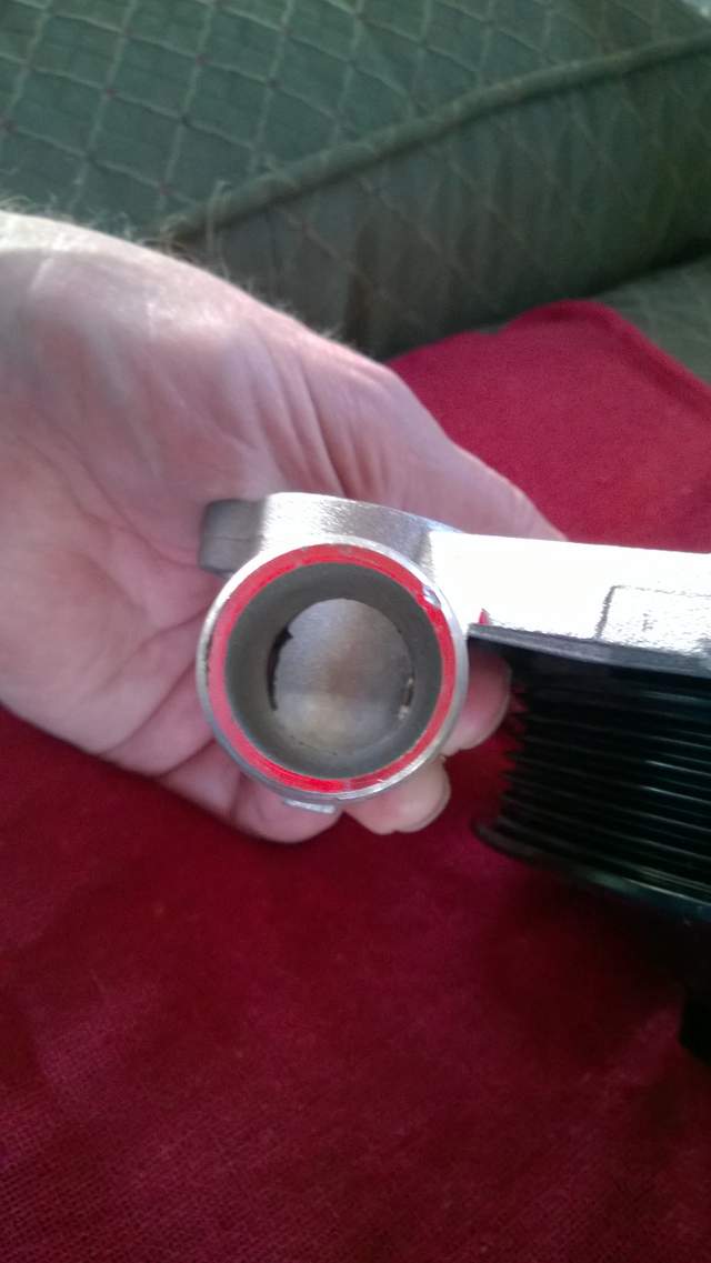

The quality looks great in the following picture, but there are casting issues.
Detail around the metal impeller and the casting; look good.
But the casting in the German original part is much finer. Probably 10x more expensive casting mold. The pictures may not due justice, but the casting finesse around the impeller cutout in the German part is exquisite.
This image shows a casting fault in the Autozone pump within the water passage. The black silhouette inside the passage is metal that I used a dremel on to remove to smooth out. Still, I was very glad for the metal product as shown below.
