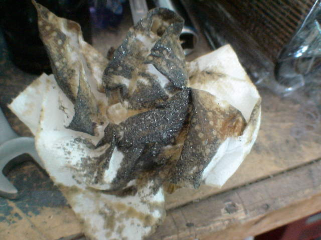

I think the failure rate on these engines is HIGHER than is being reported. I too suffered a failure at 68,000 miles on the clock. As of now the cause is not entirely known. Must rip off cam covers, IMS - AND MY WALLET!
Cheap insurance would be to PULL THE OIL PAN when doing a oil change. Why? Because my oil filter only had 1-2 little small bits in it….on the other hand my pan looked like this….
http://986forum.com/forums/uploads01...1371916959.jpg
No bits were in the oil uptake screen. No confirmation it is even an IMS yet. I picked up this much "powder-type debris" from the oil pan - even when the oil filter was almost clean!
Here is a shot of the practically clean oil filter in the background and all the fine debris on a paper towel in the foreground….
http://986forum.com/forums/uploads01...1371917305.jpg
Even tough I have changed the oil 'religiously'! As they say, "When it is your time to go…"
She has been parked for an another agonizing month AGAIN! There is NO TELLING WHEN THE IMS demon will strike!
NO WARNING in my case either…..so IF you can learn from others - better pull the oil pan!
I am growing weary of Pcar reliability issues….don't you think for a moment that the IMS is the only failure point in these engines.
Those of you who HAVE working engines, good for you! Live well BEFORE YOUR TIME IS UP!
Anyone got a line on another engine besides Porsche to put in there in the $6k range?
TeamOxford 06-22-2013 11:15 AM
Sorry to read of your engine's demise, Homeboy. :( Hope you can find a suitable solution, rather than ending up with an expensive roller.
The IMS issue is a hot topic indeed; this should cement the notion that the only foolproof way to address it is to install the upgraded bearing.
Costly, yes, but one sleeps better at night knowing that the issue has been resolved. People can write all they want about failure rates, oil types, low temp thermostats, guardians etc., but the fact of the matter is..................it can happen to anyone of us at ANY TIME.
What kills me is that people will argue endlessly against replacement because of cost, but have no qualms about their "mods": plunking down thousands for Carrera wheels, RUF bumpers, and GT3 seats.
Not that there's anything wrong with that................;)
As always, that's me, and I'm just sayin'..............:)
TO

southernstar 06-24-2013 05:05 AM
I am so sorry to hear this, homeboy. I thought you had replaced your IMS bearing with a Casper engineering ceramic fairly recently? Regardless, please keep us posted on the cause, if and when it is determined. I too hope that you can find a decent engine at a decent price. I have my finger's crossed, amigo!
Brad
TeamOxford 06-25-2013 12:40 PM
Homeboy, in reading some of your past logs, I see you have already installed the IMS upgrade, so I doubt you had an IMS failure.
Don't know what could have possibly happened to your engine, but I feel your pain. :(

mikefocke 06-26-2013 11:31 AM
So how much was the problem a Porsche problem and how much was the folks who worked on it? What was their experience level and did they do the install right the first time? (We know thousands of LN installs have been done successfully but we also know of some really botched attempts)
Was the original engine free of debris when the original bearing replacement was done?
Does LN ship their bearing packed with any sort of grease to reduce initial rotation wear until it gets enough oil? Would that explain why the two bearings rotate differently?
What ever happened to the LN bearing? Did you ship it back to them? Or did you sell it to someone?

This.... How much of this debris was in the engine before the bearing replacement? When we do a bearing upgrade for a customer we always pull sump plate and filter prior to any disassembly regardless if it is just "while you are in there". If ANYTHING alarming is present we simply inform the customer the money would be better spent opening the engine for a rebuild.
And Mike, he used Casper Labs bearing, although I doubt it was the new bearing's fault for that debris.
Skoot
stephen wilson 06-27-2013 04:27 AM
I agree with Mike. Sorry Homeboy, but you've had lots of "odd" issues, and I'm not convinced it's Porsche's fault. It seems you don't even know if it's the IMS bearing yet.
