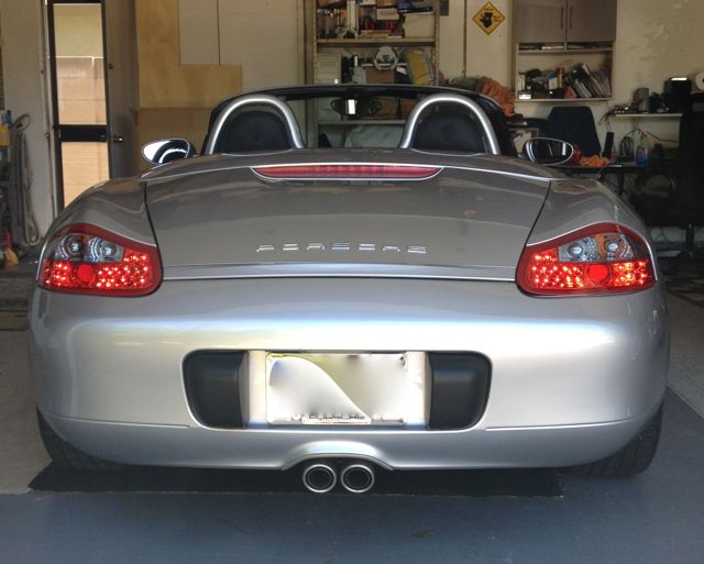

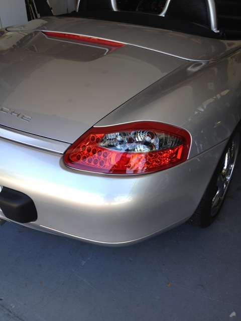

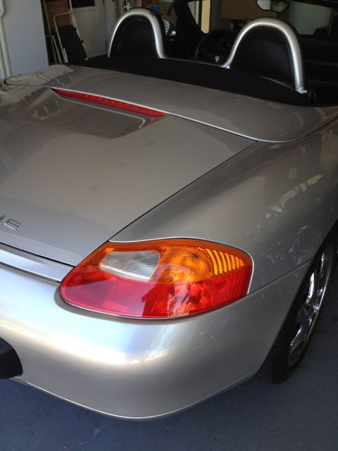

tony_fury 11-19-2012 07:53 PM
3 Attachment(s)
Here is the right side before & after
Attachment 16776
Attachment 16777
Rear both
Attachment 16778
Meir 11-19-2012 08:10 PM

mcomet 11-19-2012 09:02 PM
Thanks for posting. Definitely way better than the older triple color lights. I am not sure about the red ring all around... My stock 2003 s has the silver top and red bottom.... Hmmm....
mcomet 11-19-2012 09:29 PM
Yeah... I used your pic to photoshop on my car... I definitely think my stock is better without the red border all around...but it looks really really good on your car...
Stock:
http://www.comet-cartoons.com/porsch...MockBefore.jpg
Photoshop:
http://www.comet-cartoons.com/porsch...tMockAfter.jpg
tony_fury 11-19-2012 09:38 PM
mcomet:
Nice phot0shop job..
@Meir:
Smoke would look better on a dark car..
