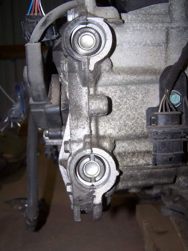

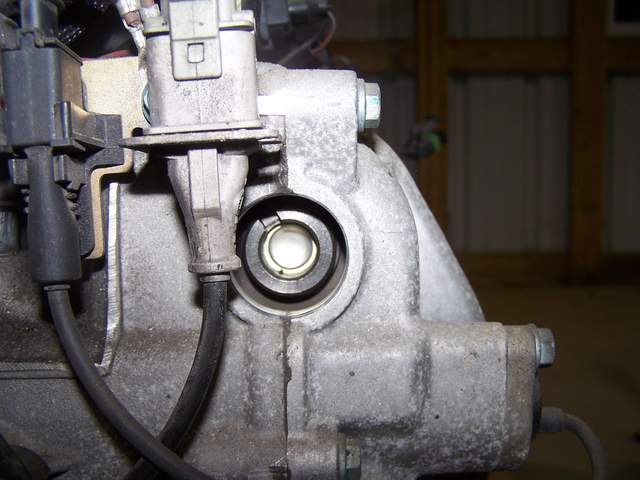

Post some pics of where the notches are in both banks. Lock the crank at TDC when taking the photos. This is a somewhat common issue and has several contributing factors, some simple, some huge.
Worst case you can ship it this way and we can find why the timing moved. Don't just reset the timing, the issue is screaming that an underlying problem exists and it will find you if you don't find it first.

Pass side
Pass side
Driver side
Driver side
Let me know what you think it might be. If i have to send the engine off to have the work done i will send it to you, I have heard nothing but great things about your work.

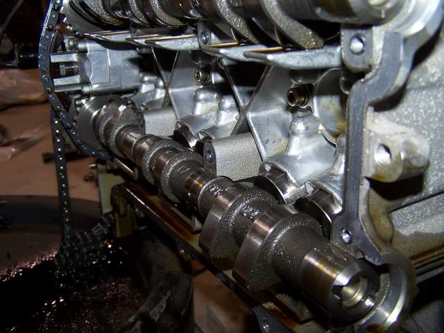

Posts: 29
When I pulled the cam cover off the chain fell right out.
edwardneff94 is offline   Reply With Quote
Old 07-18-2012, 05:18 PM   #20
Join Date: Aug 2011
Location: Lexington OK
Posts: 29

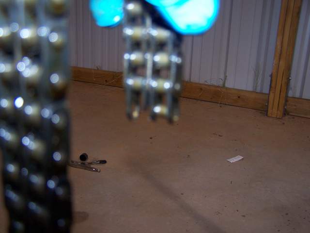

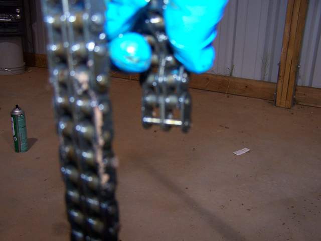

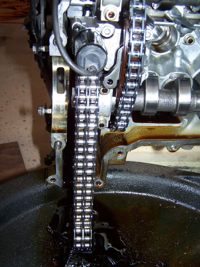

Close up of chain.
Pic of cams.
Pic of cams.
Chain
Chain.
