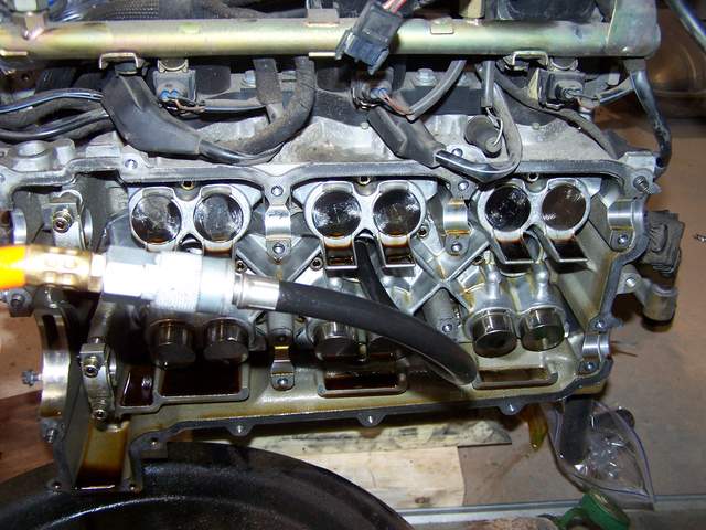

edwardneff94 07-19-2012 04:45 PM
Todays update, I just finished testing each cylinder and here are the results, cylinder #1 gave me a nice cooling breeze from the intake, while cylinder #2 helped to beat the 105 degree heat with a breeze from the exhaust, cylinder #3 was the only one that did not have a leak.
http://986forum.com/forums/uploads01...1342741333.jpg
Pic of test on cylinder #2
http://986forum.com/forums/uploads01...1342741391.jpg
Plugs from left to right, #3,#2,#1
feelyx 07-19-2012 05:51 PM
Did you tap on the valves to make sure there is nothing stuck under them? Chances are they are bent... but you never know........

Jake Raby 07-19-2012 06:55 PM
Exactly what I expected.. Do you know how many shops would not have done this test and tried to repair it without pulling the head?
It sounds like it needs to come see the magicians:-)
As long as you didn't hear air in the crankcase we are still in business.
edwardneff94 07-19-2012 08:10 PM
I did not hear any air in the crankcase, I have bags over all the hoses and open ports in the engine to keep junk out, none of the bags showed any sings of air so i hope that is good news. Thank you for taking the time to talk to me today and for all your help throughout this process. I will call you and try to figure out when i can get it out to you.
