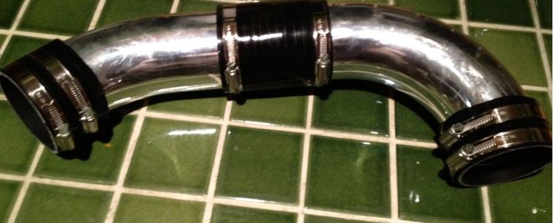

I started by cutting the lips off each end of the angled pipes then I put them next to original pipe I had removed from the car to check the length was ok.
It worked out that once I joined the two pipes in the middle I just had to shorten the ends to make it fit (more off the 45 degree angle than the 90). It took two attempts to get the shape right so it fitted to the car properly. It is better to cut off too little and be able to cut off a bit more than just chop off a big piece and ruin it. Also you might want to slightly angle your cuts to make it fit more accurately.
I used a full 100mm rubber for the join and cut one in half for each end.

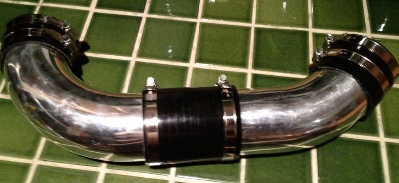

Fitting it to the car was a bit of a fiddle. The pipe exiting the airbox is slightly wider than the 76mm hose. I suggest that you start by putting the shortened rubber on here and tighten the clip then assemble the rest of the unit working up wards rowards the engine. Make sure you point the screws on the hose clips in the direction you can get at them afterwards. In the end I left all the hose clips a bit loose and wriggled it around until it went on then tightened the clips up when I was happy it wasnt touching anything (engine or car body). Here is a picture to show the end results.
A pretty nice job I thought! It cost a total of about £55 and took me 1-2 hours to make. The parts were good quality from this ebayer. All I used was a flat screw driver, a hack saw and a file to clean the pipe cuts up and a craft knife to cut the hose.
I took it out for a run and the butt dyno says its a big improvement. No real change to the sound but it seems to rev much more cleanly especially at high revs.
