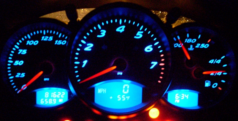

Drew, can you post a pic of your blue illuminated cluster? It would be nice to see what it looks like.

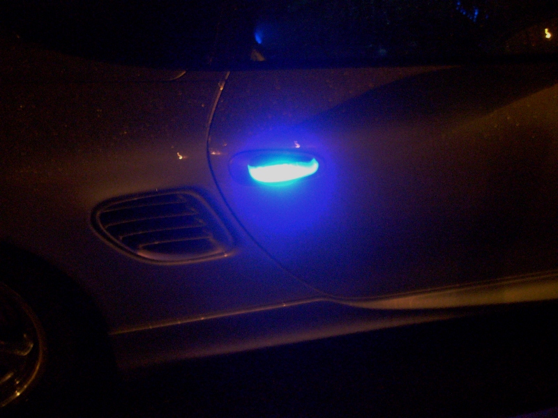

stcroixdrew 11-29-2011 03:44 PM
Blue as requested
2 Attachment(s)
Sorry for the slight blurrr...I ran out in the monsoon we are having here in Philly right now. Plus it matches my LED door handle Puddle lights I installed...
Attachment 15720
Attachment 15719

thstone 11-30-2011 10:10 PM
Wow. Those blue LED's make the stock lamps look pretty low rent. Thanks for getting the pics in the rain, much appreciated!
