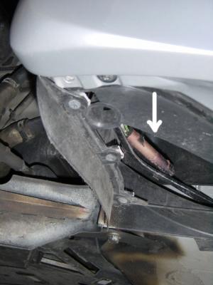

There is also a small resistor mounted by the radiator that craps out, but can be changed without too much hassle.............

thanks guys, switched around the relays and they all seem to be working.. so i guess the resistor is the next in line..
im assuming I need to remove the front bumper to get at the rads?
