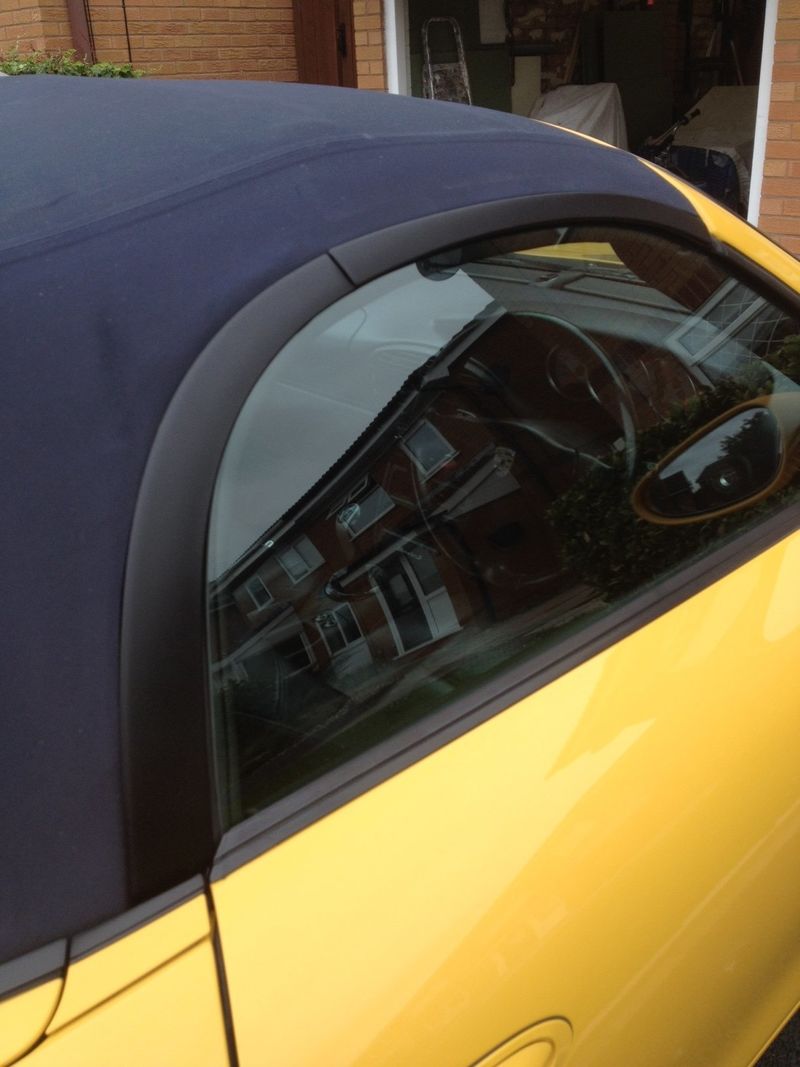

Iv painted my roof bars
Hi Guys
After washing, clay barring and polishing my S a the weekend I decided to put right something that has been annoying me for a while....
The roof side bars seem to have lost a bit of their colour and picked up a few little scratches in their 17 year life.
I carefully masked them off then gave them a very light sand down, wiped them with some panel wipe and a tack cloth then sprayed 3 coats of satin black.
From start to finish it took about 40 mins.
Im very happy with the results as they look like new now.

After
Here is a picture of the finished result
