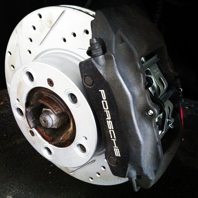

Got this set from E-Line, Great price on eBay, Posi brake pads make no dust at all, and hardware included. Feels no differnce from OEM pads. Previus pads was Pagid and that make lots of dust.
I use them for street and its more than good.
