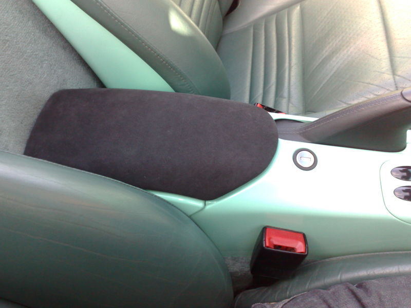

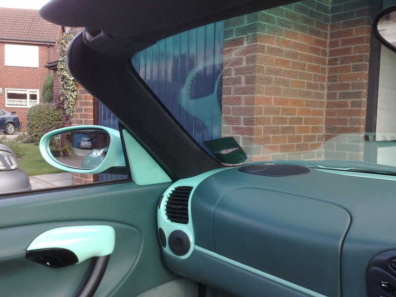

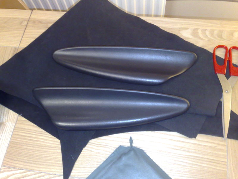

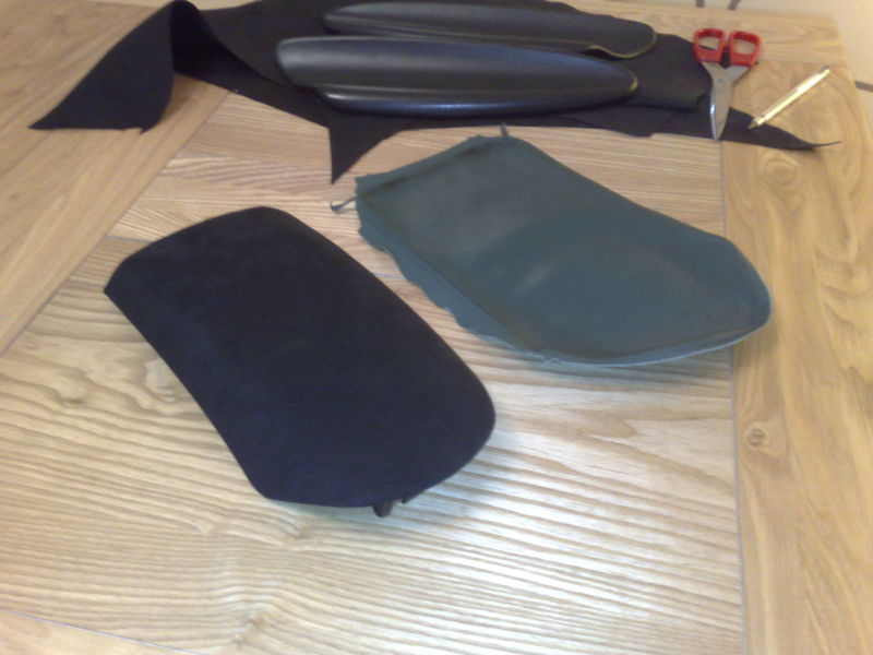

I re-covered my pocket lids, arm rest and leg pads a few years ago now with black alcantara I also covered the windscreen surround too
Sorry the picture quality isn't great but the alcantara is holding up well!

Question: Is that real Alcantara or the UltraSuede stuff?

That is genuine Alcantara it wasn't cheep but the quality was good and it's stood the test of time.

I actually did this back in 2009 and from what I remember I paid about £80.00p for one and a half linear metre of black Alcantara 9990, I removed the original leather from the centre console before gluing (the old arm rest cover can be seen in my previous post) but the door pocket lids and windscreen surround were finished in plastic and the Alcantara was glued directly to them.
With regards to thickness I haven't got a clue, pretty thin maybe .5mm and very easy to use.
