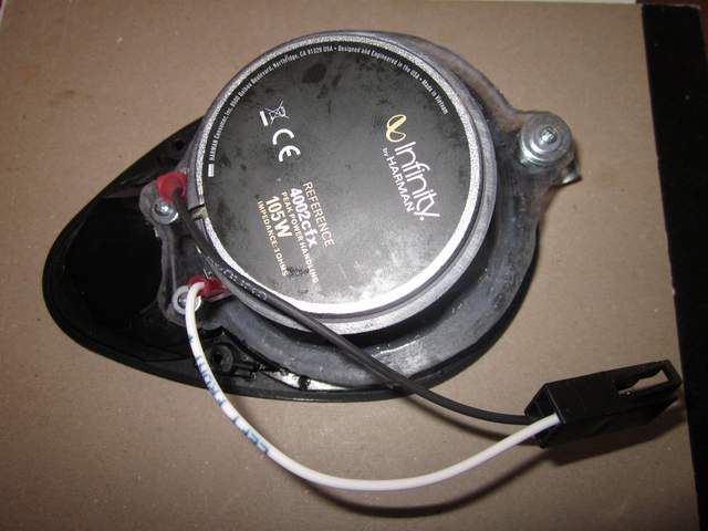

I saw in several threads that there were some adapter plates available, I could not find them and I did not want to destroy the factory speakers to mount the new ones so I made some.
I used 3/16" Lexan. I went to a local plastic store and found a piece of scrap 6" x 24". They charge $1.00 per pound, but went I went to pay, they just gave it to me!
I cut out the plates with a rotozip and then used my angle grinder to smooth and adjust for final fit. You also need to grind off the mounting tabs on the speakers. I found the speaker adapter wire with the correct connector at Crutchfield for $10.
I used silicon caulk to "glue" the speakers to the plates
I have a template for the adapter plate, so if you are interested, PM me and I'll email it to you

New speaker mounted with adapter plate and speaker connector
