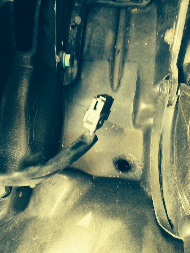

There were no issues at all removing the Bose system speaker on the back shelf just remember to unplug the connector wire on the passenger side of the car

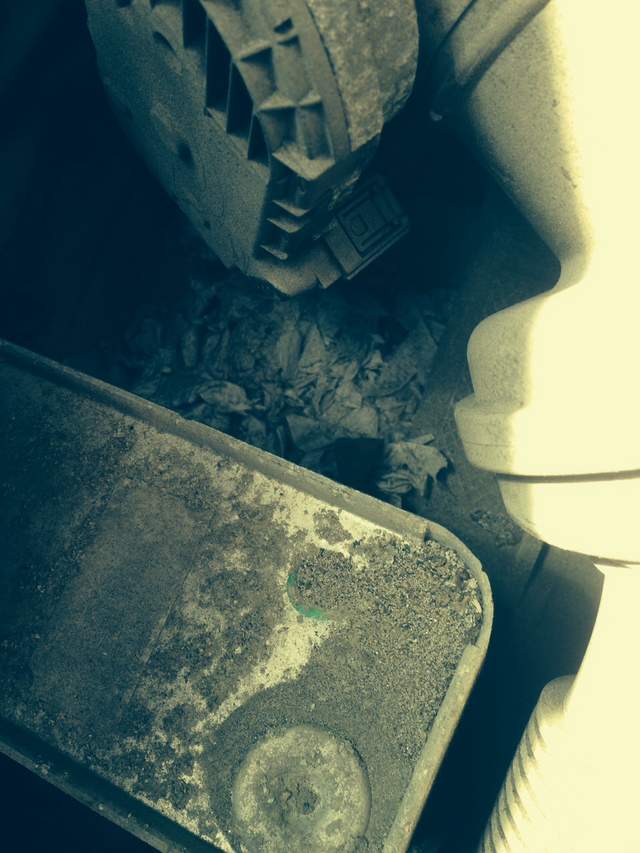

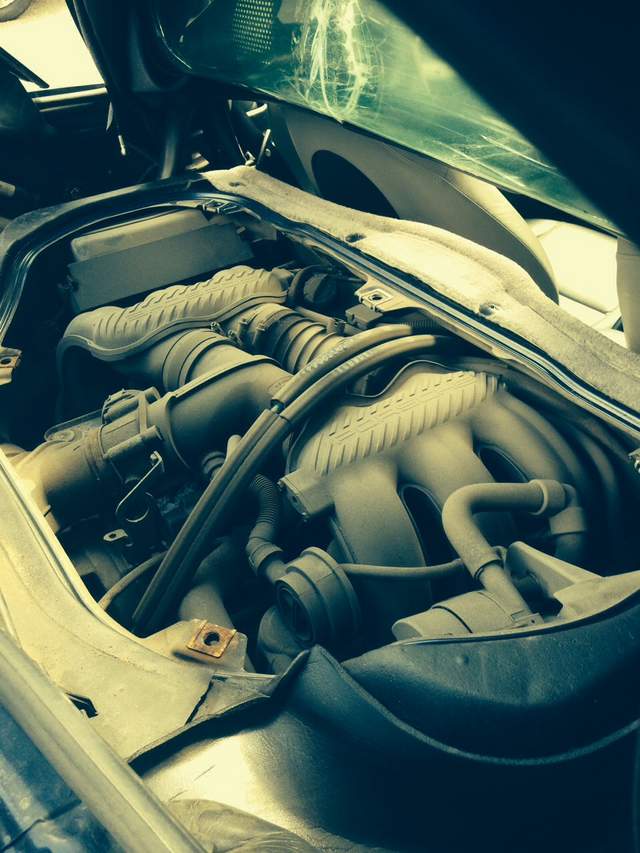

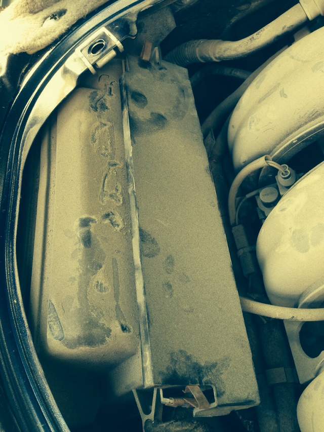

I think it is a good idea to take a hand held vacuum with you to clean out any mess you find in the engine bay. I do need to clean my engine but will do this at a later date. Any suggestions on what to use to clean the engine?

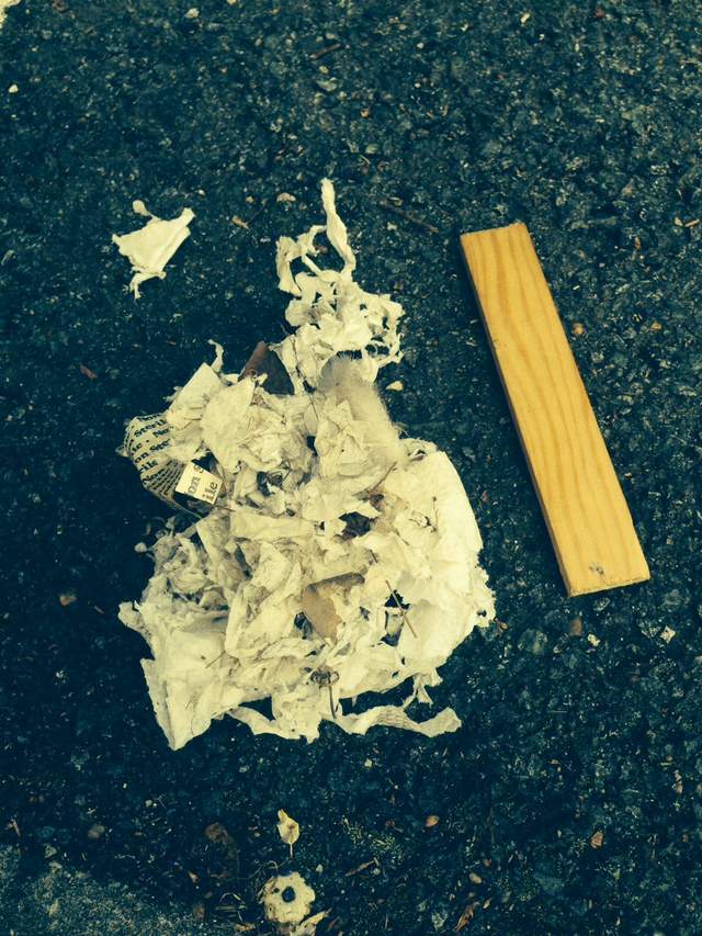

There was some rubbish in the engine bay. Looks like tissue paper and a few feathers mixed in with a piece of wood

on the passenger side there is a plug just under the shelf that you have to unplug

As Fintro11 stated, there is a plug for the wiring on the passenger side along side of the rollbar. You have to pinch the sides to release it, and on mine I typically find this the hardest part of getting into the engine bay.
Once the wiring is disconnected, there are two "thumb screws" on top of the bose speaker. Turn those to loosen the shelf. Then you can just lift it out.
