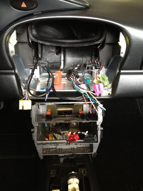

I have measured the connectors and it seems pins 10 and 11 on the red plug are ignition switched 12V. They go to 12V when ignition is switched on but go back to zero when the key is turned back to the ACC position, which is not really what I want.
I prefer not to have to have ignition on to be able to run the radio. There should be a possibility to just use the ACC position, no?
I seem to remember the stock radio would remain powered until the doors were locked.
If only the pinouts of the a/c display were available somewhere...

Thanks. I think I will get the switched power off the fuse block after all.

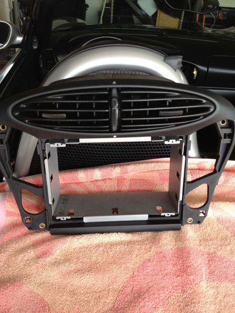

I started dismantling the dash today, the objective is to get full access to the radio cavity and get the radio surround on the bench for easier adjustment of the new cage.
But I hit a brick wall. I do not know how to remove the plastic frame with the cupholder and the two vents. I got the "horseshoe" off (boy were those colored switch connectors a B&#%£ to get off), loosened the four Torx screws plus the two holding the metal radio support bracket, but there is something holding the vent/cupholder section still that I don't know how to deal with.
I thought it would be just a couple of clips, but I have pulled pretty hard and I feel if I pull any harder it will break into pieces.
http://litby.org/photos/dash.jpg
Or do I need to remove the cupholders and vents separately? Appreciate some quick help.

They changed the design from MY03, I believe.
The reason I want to remove the entire frame is that I want to do the cutting for the new radio cage out of the car, and also removing the factory radio support bracket (which in my car is U shaped and seems to be joined to the vent assembly with clips) will be easier.

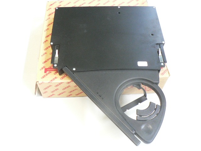

tony_fury 09-05-2012 08:00 AM
I got that image from Pelican parts replacement cup holder diagram.
Pelican Parts - Product Information: 996-552-183-00-01C-OEM
Might try a parts catalog for a 996..
politby 09-05-2012 08:27 AM
Looks like the cupholder may just slide out if those locking tabs are pushed down:
Attachment 16516
Someone must have done this on a 2003-up. Anyone?
SoK 09-05-2012 09:21 AM
looks like the locking tabs you release when inserting the radio removal keys, any chance there's an opening there for them?
politby 09-05-2012 09:32 AM
I think there's even room to insert a finger or at least a screwdriver. It's inpossible to see in there, I need to try a flashlight.
Pretty sure the cupholder must come out in order to remove the radio bracket; they are interlocked.
Pretty crummy design, this - and the plastic parts seem so fragile.
