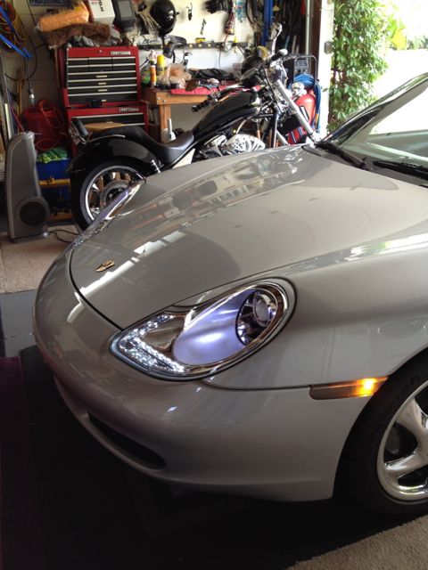

some more pic's
Size:  50.2 KBName:  IMG_0370.jpg
Size:  39.6 KBName:  IMG_0374.jpg

Adjusted the lights and took them for a ride down a dark road, light is awesome.
Talked with geetee on the phone, seems these housings have a serious tight fit when clamping them down with the wrench.
Seems there is a little tolerance issue with these lights.
I think the DRL looks the best going down the road, and the turn signals are really impressive.
All that taking them in and out, I forgot to get my Flash2Pass back in..
Left it in the old light...
LED tail lights tomorrow..
