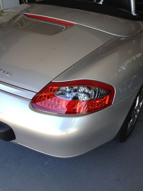

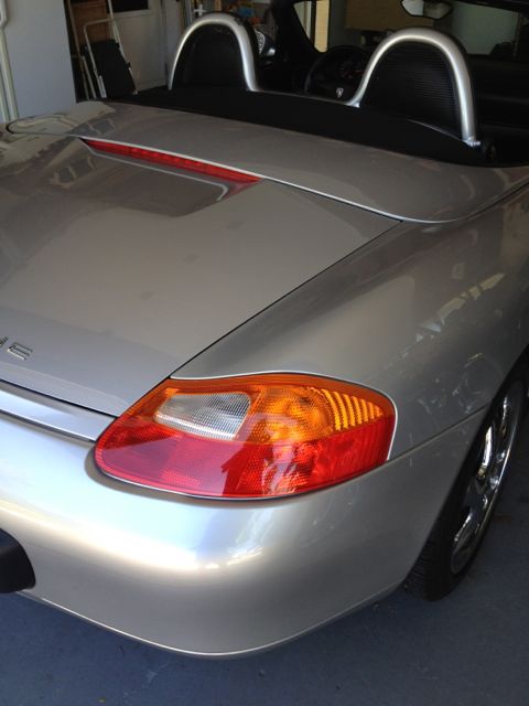

I know this post is about headlights, but put the tail lights on at lunch today.
Really modernizes the car..
Done with the mod's now.. Drive time...
Attachment 16523Attachment 16524

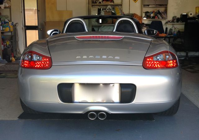

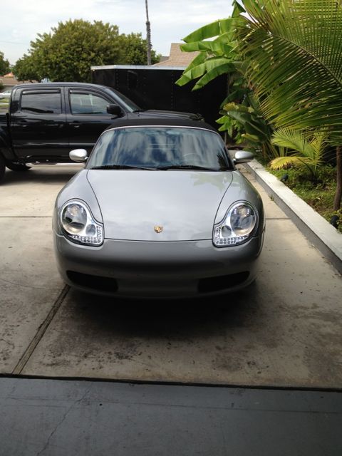

tony_fury 09-07-2012 04:40 AM
2 Attachment(s)
Originally Posted by particlewave (Post 305081)
How about some wider shots, fellas? Of the tail lights and head lights...nice to see the detail, but would be nice to see the vehicle as a whole, as well. ;)
Here are a couple shots.
Attachment 16525
Attachment 16526
