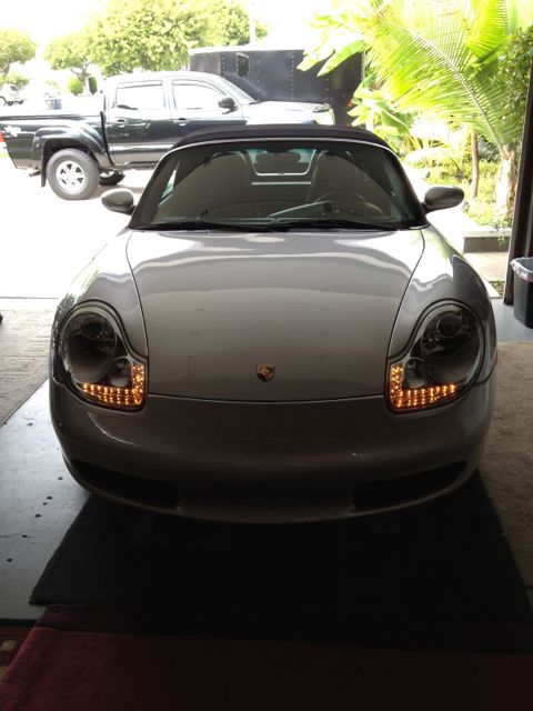

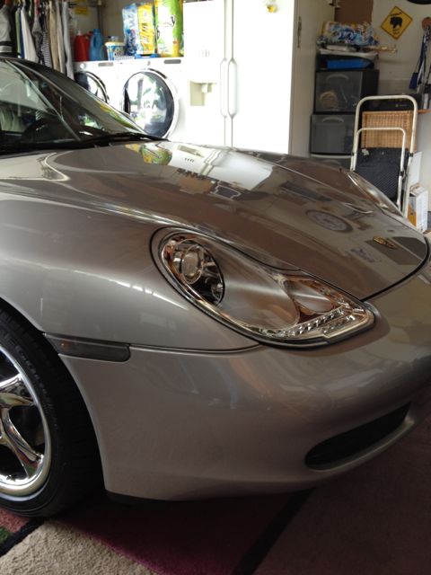

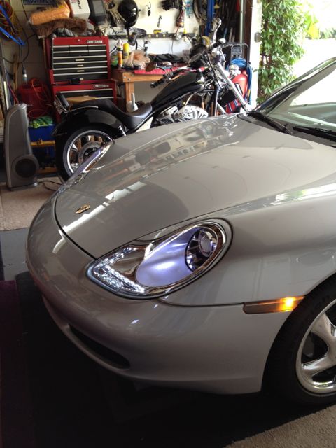

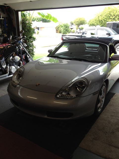

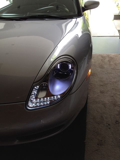

Crono0001 09-01-2012 10:54 AM
http://986forum.com/forums/uploads01...1336666274.jpg
http://986forum.com/forums/uploads01...1336666303.jpg
http://986forum.com/forums/uploads01...1336666384.jpg
http://986forum.com/forums/uploads01...1336666465.jpg
http://986forum.com/forums/uploads01...1336666470.jpg
Zenith Blue

^^^^Got one in Lapis Blue?:D Thanks Crono0001. The chrome actually looks pretty good IMO.
