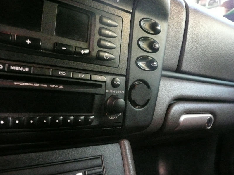

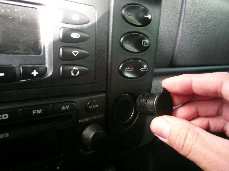

This, however DOES match:
Gary H is offline   Reply With Quote
