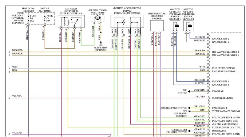

Fuel Pump Wiring
Does anyone know the wiring sequence for the plug on top of the fuel tank sending unit? Thanks, Bob
