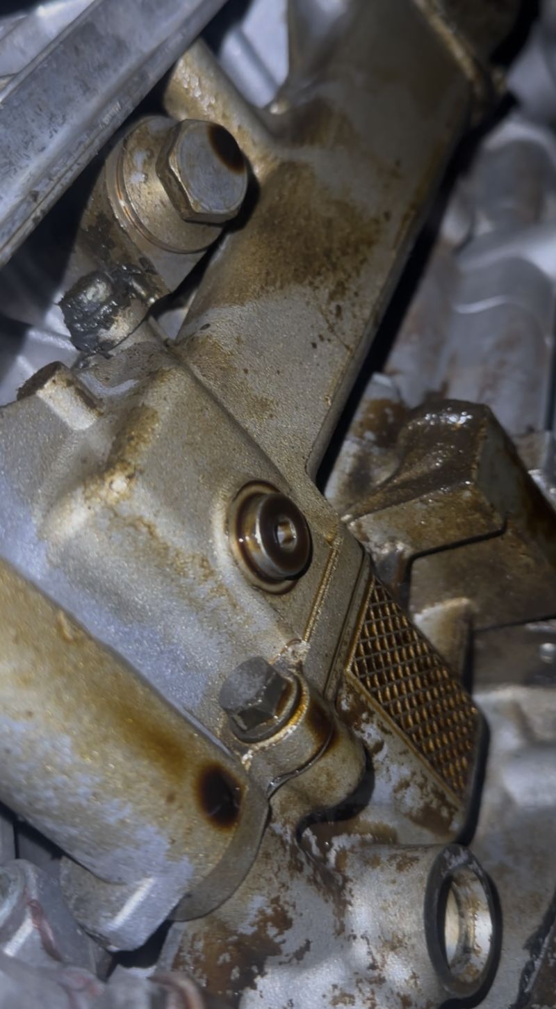

I rebuilt the M96.23 Boxster 2004 engine (in Dealer) around 1 year now (10.000 km) and after a spirited driving yesterday i saw oil drops on the left side the next day. I removed the plastic panels underneath and took some photos.
1. Belt, Crank pulley and the area of pulleys is clean.
2. It seems its coming from the oil pump in the front of the engine. Not quite sure.
3. Both oil pumps are new.
4. I estimate the oil loss to be around 200ml but not sure if it all happened yesterday or has been happening for few days/weeks.
New AOS a month ago ( unfortunately Rosepassion sent me a !@$& aftermarket one) so i doubt it can be the aos.
Not sure where to start now and i dont want to get back to the dealer again...
THANKS as always..

Clean the area with the oil on them, top up your oil and add an oil compatible UV dye (Uview and others make it, can be found on Amazon), then run the car for a couple of hours. A black light source will then be able pinpoint the source of the leak.

That leak definitely does not appear to be new... Clean area thoroughly, take a picture of it spiffy. Fill it up and let it run (hopefully w dye) w minimal if any driving and diagnose from there.

Thanks for the replies, I couldnt find dye easily in EU so I did the foot powder spray method and pinpointed the issue coming from behind the Engine mount. Maybe it’s the oil pump

No i didnt ask for warranty but it should be 2 years. My Oil pump is new (the cover too) but the oil pump gaskets were elring (new). Is it possible that they are leaking after 10k kms ? Or porsche engineers f* this up

I don’t trust the dealer now. Unfortunately they used to be good couple years ago but now the 25+ years (of experience) mechanic has been replaced by a 2 (years of experience) guy. By the way the leak is coming from the oil pump cover o ring.

In the first picture, it seems that the chain tensioner is leaking? The o-ring should be easy to replace after locking the cams, am I right?
EDIT: Before yo do anything, you should clean properly the area to ensure the source of the oil leak (as suggested by JFP..)
