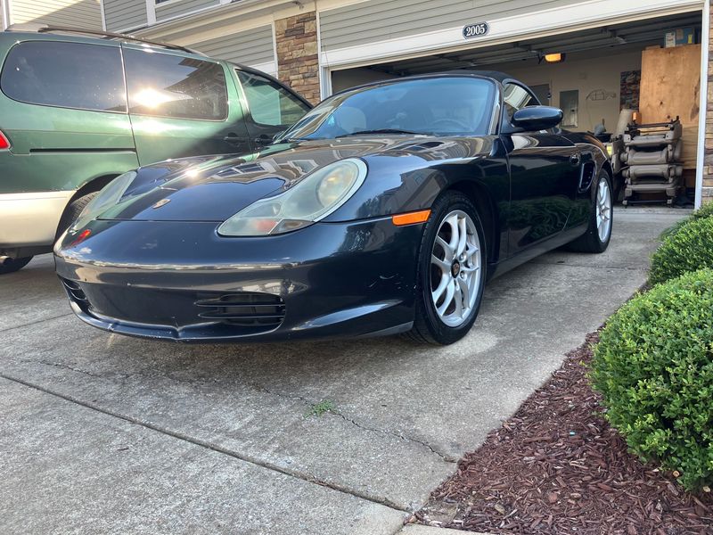

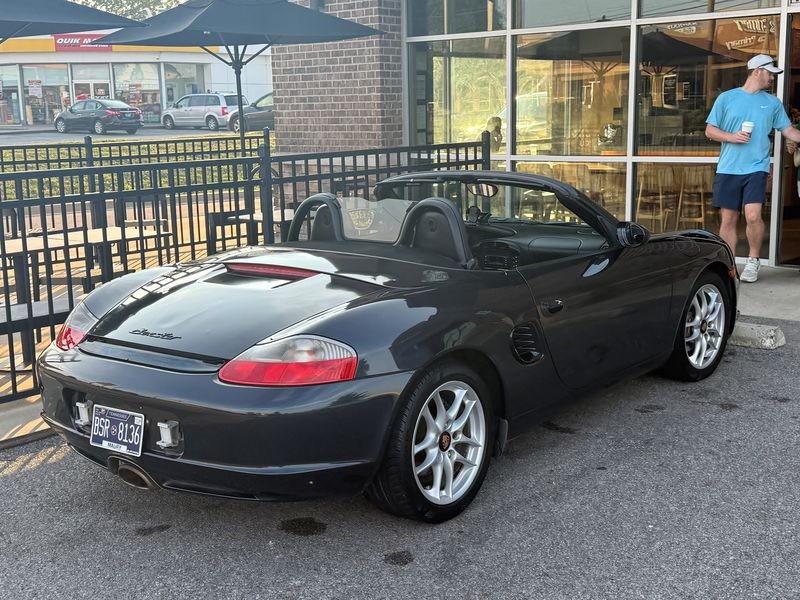

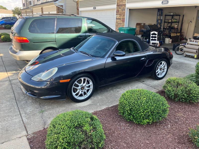

Thank you - Update
Guys,
Thank you for the time you took to reply .I could not see myself parting with this car as the body is excellent shape so further checking around and as you guys said I was able to find a Indy European shop that has quoted clutch and Flywheel job at $3300 before tax.
So I am going to get that time and enjoy driving her for more miles. While she is at 150K I am sure she has some more life in her
