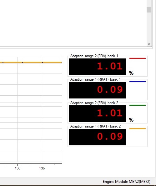

When my Durametric showed up in the mail a couple of days later, I went through all the usual business of looking at fuel trims and looking for intake leaks. I found a few things that could have easily explained high LTFT at idle (RKAT):
  • Loose intake boots on the resonance tube, enough that it would shift visiably under throttle application
  • Very leaky vacuum check valve ahead of the secondary air-injection vacuum lines
  • A cracked vacuum line to the electronic changeover valve that connects to the resonance tube flapper
  • Leaky bearing seals on the resonance tube flapper
After fixing most of that, crankcase vacuum was around 5.5"
- 6" h2o, and intake at 19-20 in-Hg.
So, that dropped my RKAT on both banks from around 5, down to 2-ish. Still up, but not maxed out.
FRA was still sitting at 1.31. No good.
Went for a drive with the durametric hooked up and the laptop on the passenger seat. Trims would stay fairly normal while driving around the neighborhood... but as soon as the car was warmed up, FRA would shoot right back up to 1.31. Lumpy idle, uncooperative starting.
Finally, I checked the fuel pressure: not quite 30psi running, then the car died, and I watched the needle on my gauge fall swiftly to 0.
Then I tested the fuel pump relay on the bench... it worked fine, opened and closed normally. I jumpered the fuel pump and tested again. This time, 25psi running. Then 20. Then 18! I was watching my pump crap out in real time!
After a new pump and a dozen or so miles, I'm seeing much more acceptable fuel trims. The car feels fantastic now! If the fuel trims stay this way, I think I'm set... right?

My car also had intake backfires, gassy rich smelling exhaust, and high fuel consumption, and in the VW days I'd look at that and say it was rich. Well, the DME knows the data, and when you make it spill the beans the truth becomes clear.
I put some more miles on the car this morning. The trims still look pretty good!
