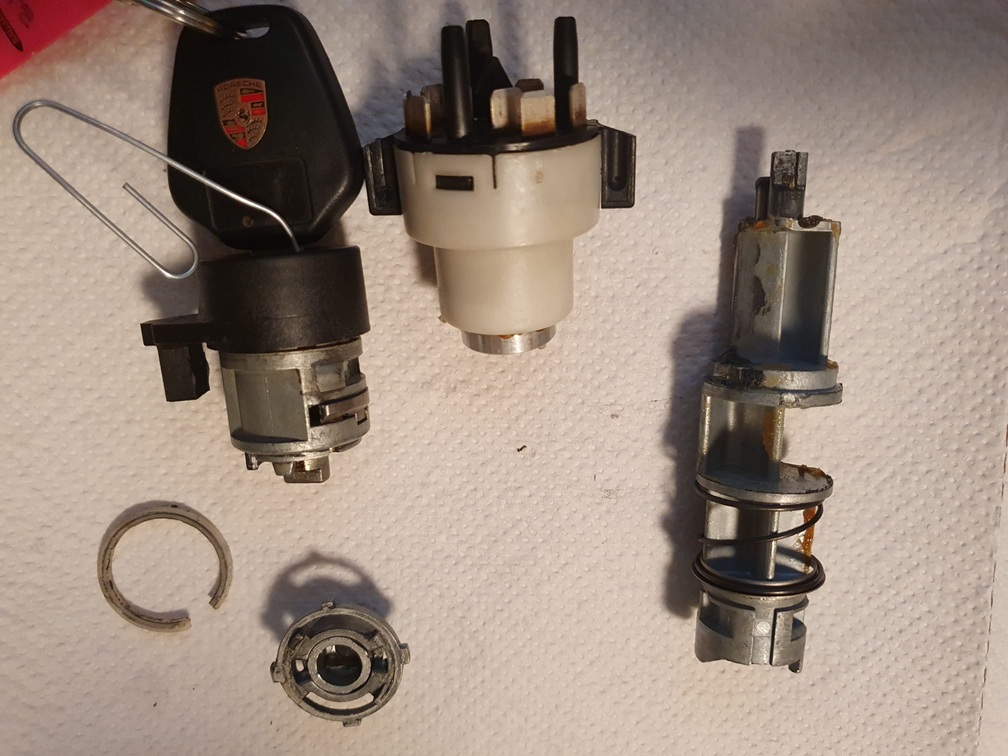

On to the disassembly. By removing the nylon snap ring the inner works can be pulled out. This is what you get inside:

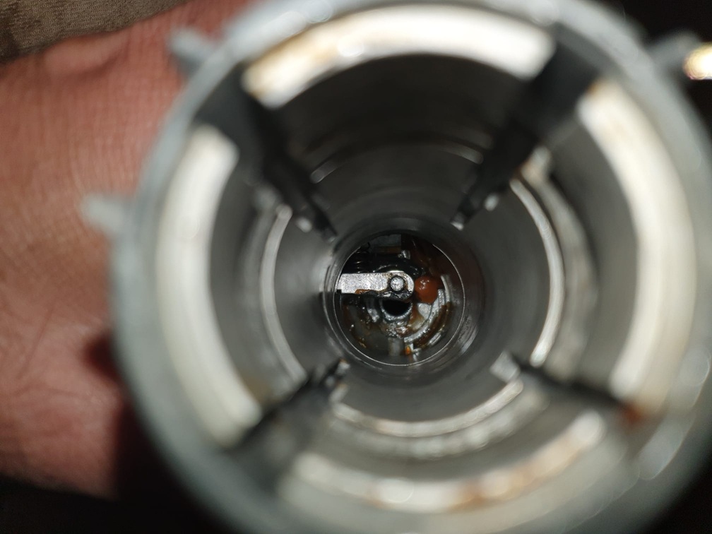

And the inside of the housing (showing the actual steering wheel lock deeper down with a spring etc.)

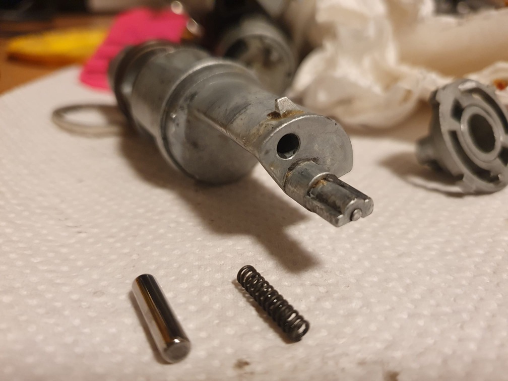

From this I didn't find any loose or damaged parts. What I did find though was grease which has almost turned solid. That's not really nice. Also there is a little spring pin at the bottom of the assembly which I think is the main spring force to keep the key barrel connected.
his pin and spring were also very very sticky. The pin did return, but slowly. So I took it out, cleaned the hole with brake cleaner and did the pin and spring as well. New grease on and re-inserted. I did the same on the other parts (the housing as far as I could as I didn't want to use brake cleaner on that with the wheel lock parts still in place). All new grease and then assembling it.
So far I now can't replicate the endless turns anymore. The tricks I learned to get me into that mode no longer work. Besides that, the wheel lock pin now really snaps out when I remove the key. Previously it would slide out slowly.

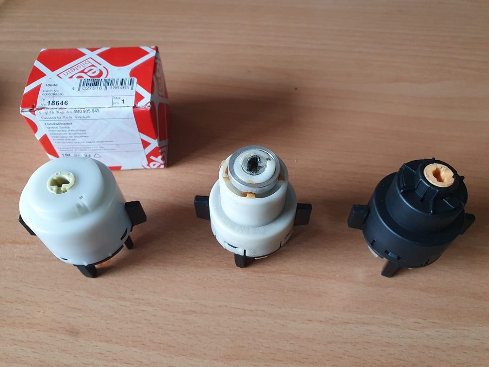

Today I received the new ignition switch. In different articles it was mentioned that 4B0 905 849 is the upgraded replacement switch. However, this one does not fit, the top of the housing is different. I'll add a picture later. So I now ordered the original number 4A0 905 849 which is due to arrive tomorrow.
Just for reference, the number on my ignitiion lock mechanical assembly is: 996 347 017 04

Today the correct switch arrived, so just a picture for reference / comparison;
In the middle the original switch, on the left the 4B0 variant and on the right the correct 4A0 number
All put back together this evening and so far it seems to work flawless and feel a lot better than before.
