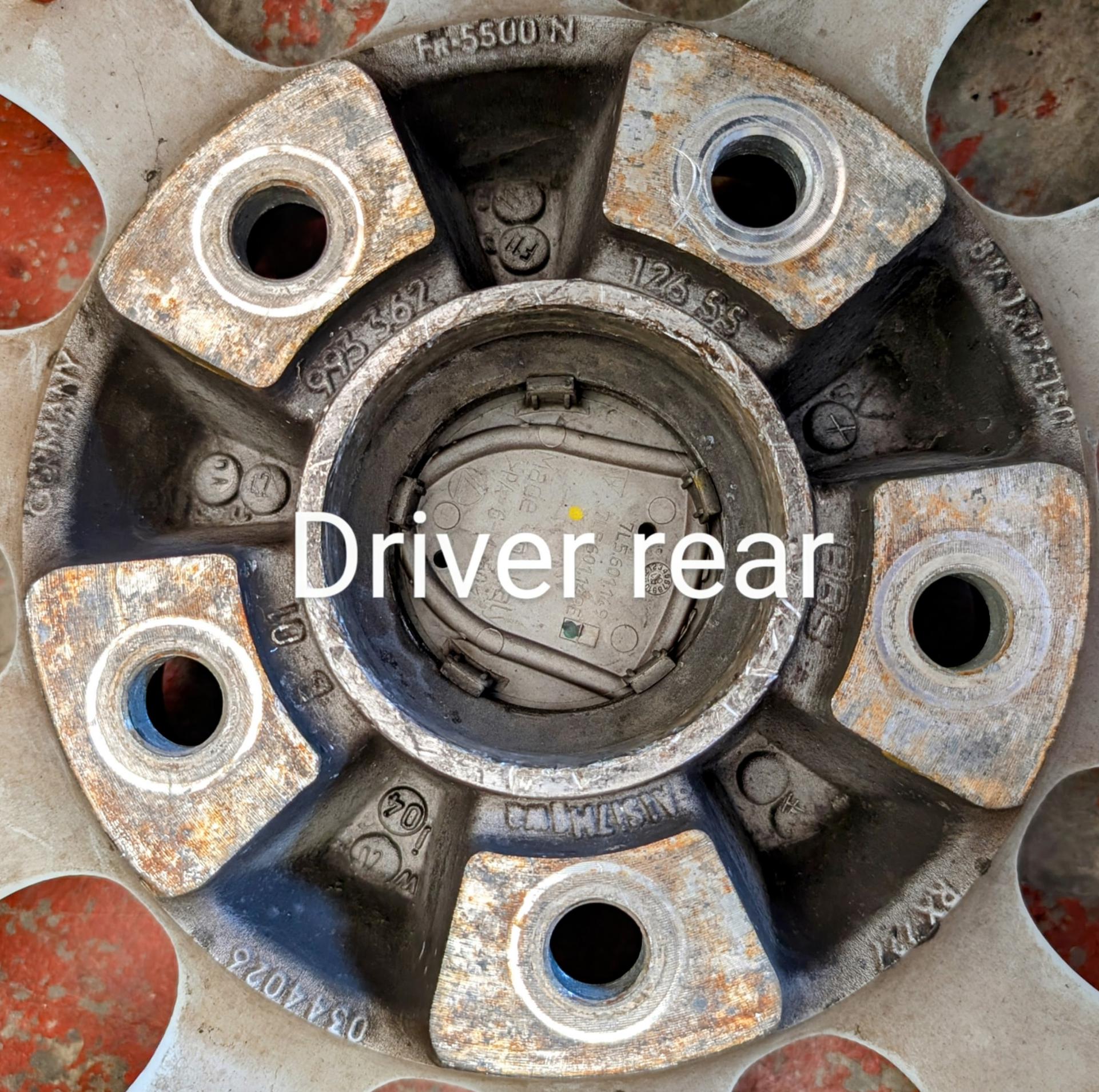

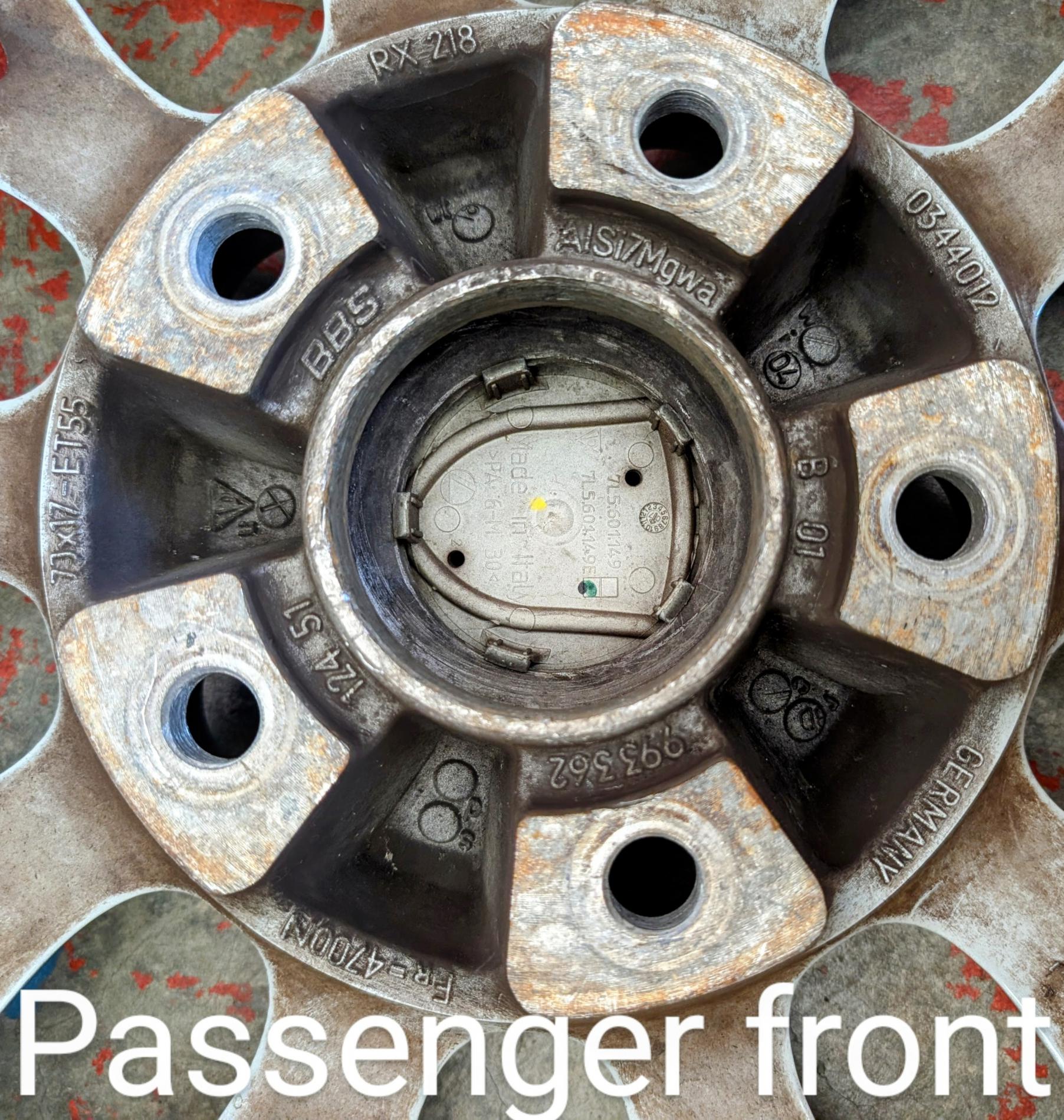

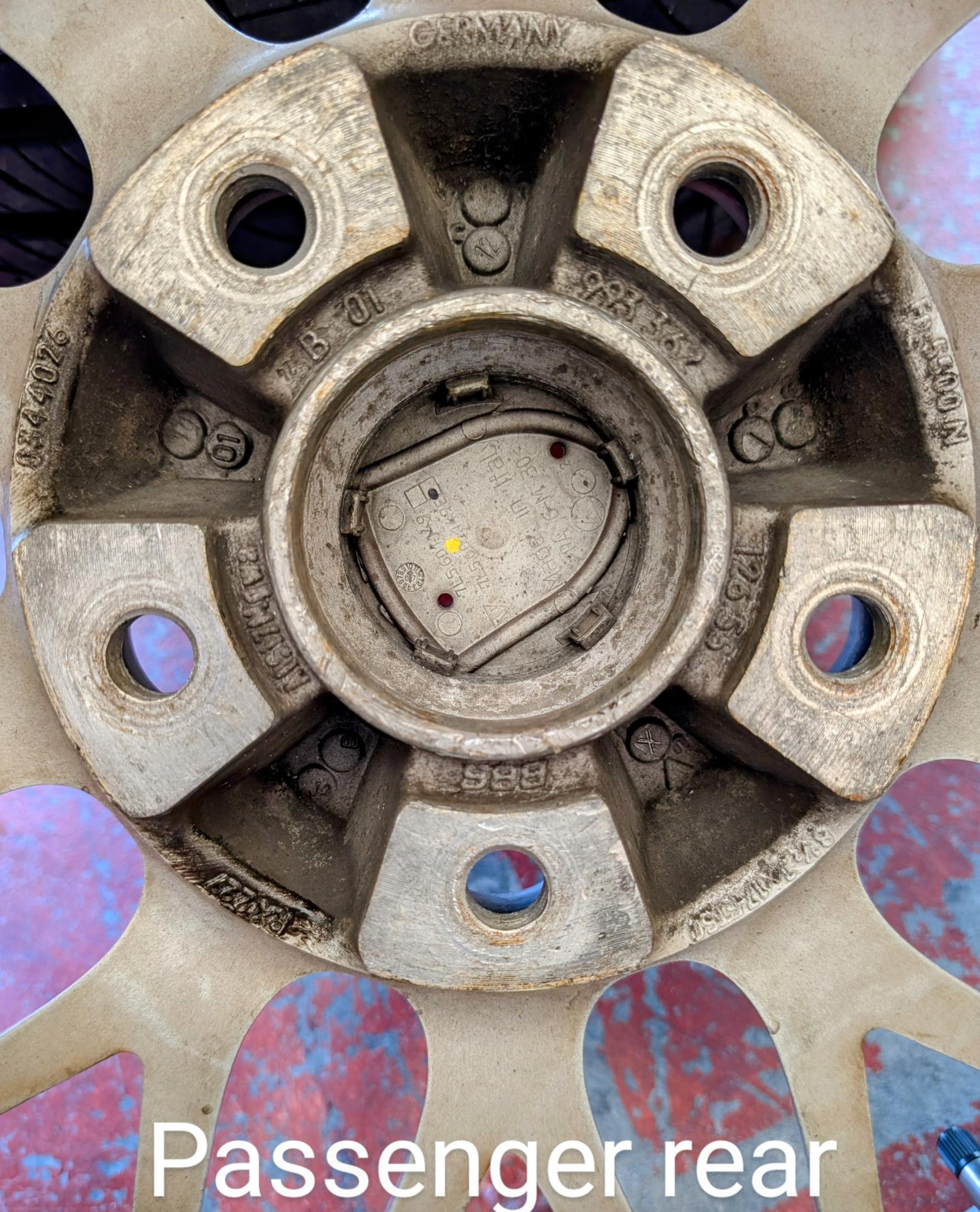

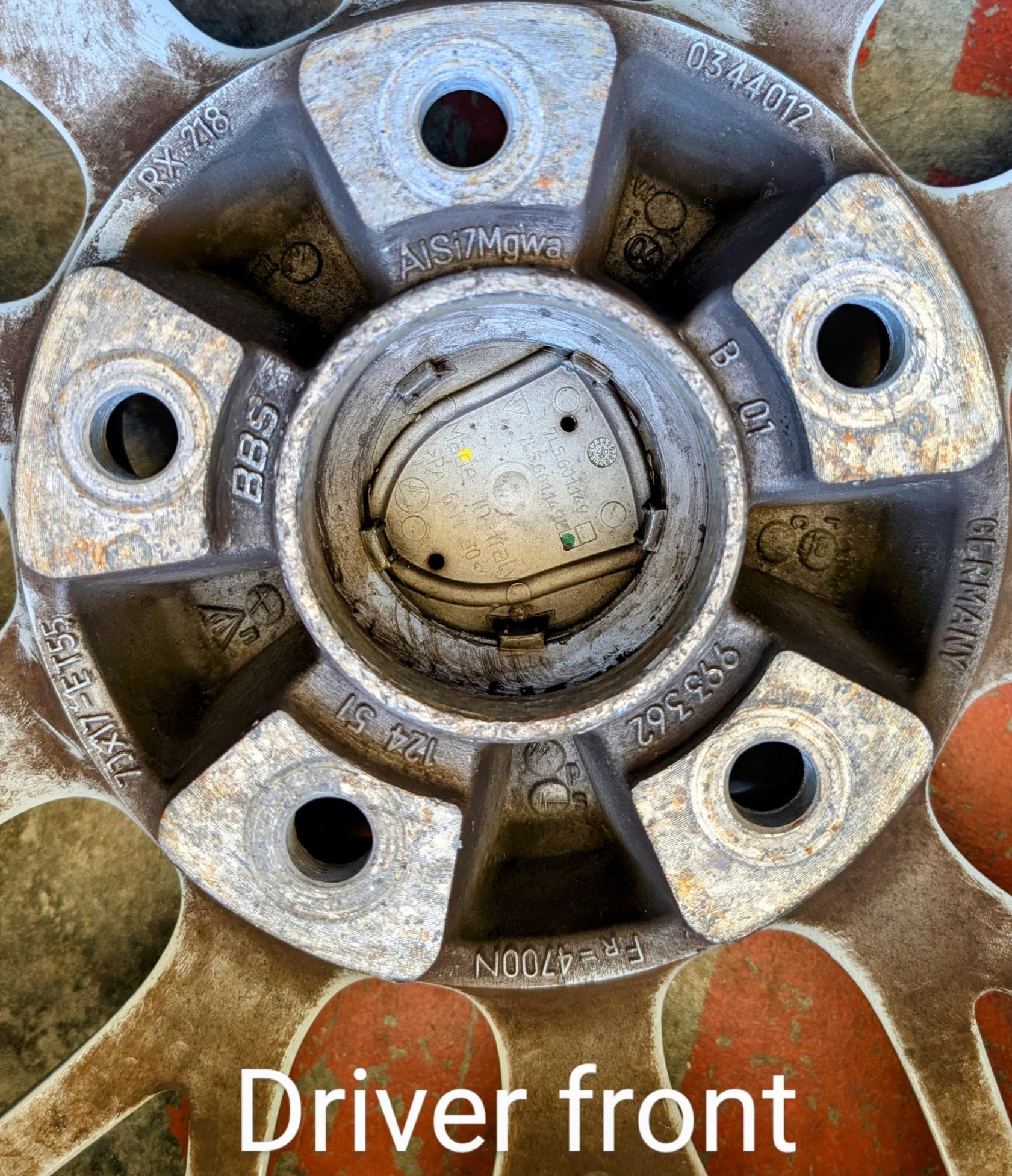

Apologies for the delay, it took a while before I had time to pull the wheels off and check them.
From the looks of it, the rears are marked with 126 55, and the fronts are marked with 124 51, I'm assuming that's what gives the wheels the different sizes?
I now have the wheels back in the original configuration, but now I'm wondering if this is actually a valid setup for this car in the first place ( previous owner put these wheels on ), and maybe this is the root of my steering wheel shake?

your fronts are marked 7J17et55 and your rears are 8.5J17et50
fronts == 7 inch wide wheel, 17 inch diameter, and offset of 55
rears == 8.5inch wide wheel 17 inch diameter and offset of 50
boxsters have a staggered setup, so this is normal, I don't see why it would create a steering wheel shake inherently. maybe a bent rim?

So, you have correctly sized wheels - 7x17 front, 8.5x17 rear. You don’t have correctly sized tires on them. Should be something like 205/50x17 front and 255/40x17 rear.
Not saying that has a damn thing to do with the vibration you’re dealing with, but it does explain what you saw when you swapped front for rear.
