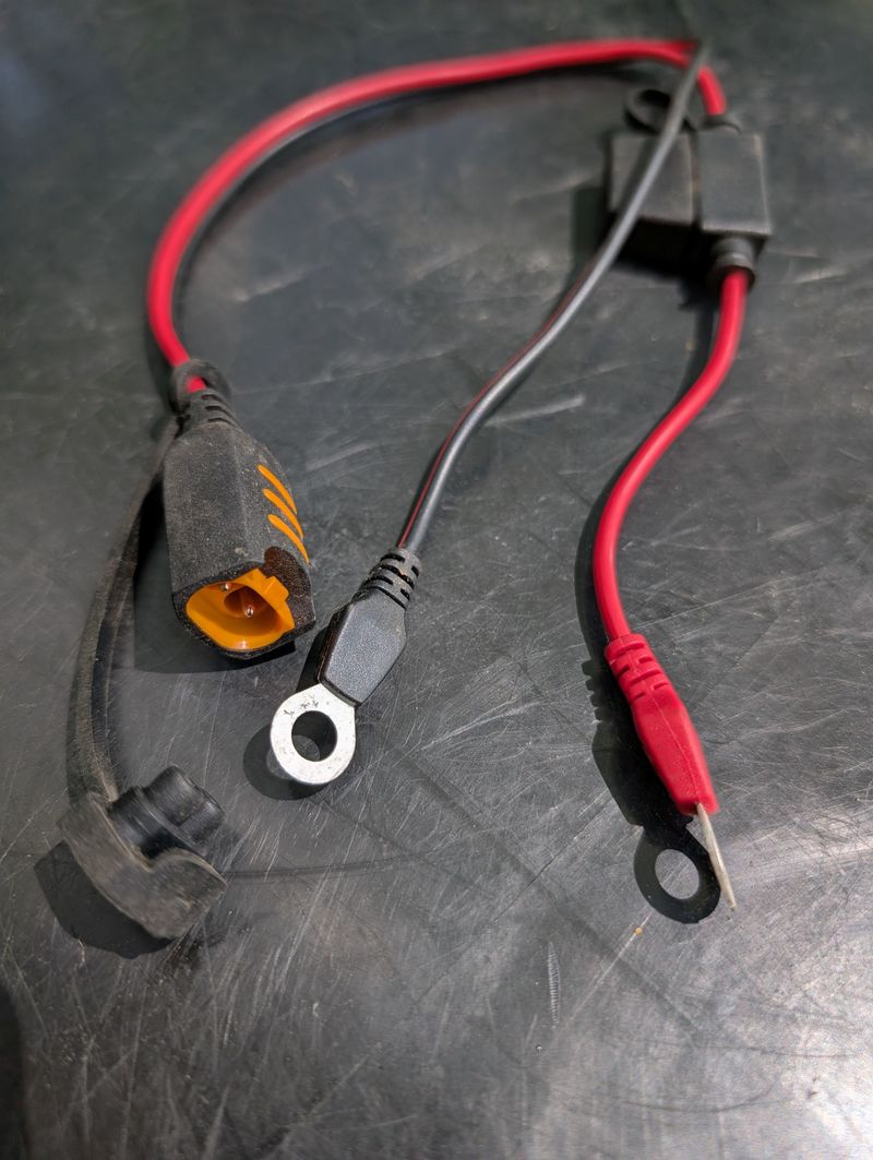

I pulled out the bag of accessories that came with the Ctek to check. Does not have a lighter/power socket plug, but it does have this:
I can attach the red one under the nut that the red clamp is attached to in my first pic. The neg one I could probably slip over the threaded portion of the bolt over there at the top of the strut and throw another nut onto the exposed threads to hold it on.
Thanks for the suggestion

Location: PA
Posts: 1,726
Originally Posted by Frodo
A good thought...I had been a little concerned about clamps popping off (esp the positive one).
You're welcome!
My concern is that if you loosen that nut to put the eyelet under it you'll lose contact and defeat the purpose of your effort. I can't tell for sure because the clamp is in the way, but you probably even have enough thread on the top bolt of the positive terminal for the eyelet and another nut. I think it's 10mm. It just has to grab for a little while, you don't need to thread all the way through the nut. If you don't have enough thread, do you have any old device that plugs into the cig lighter that you could sacrifice its plug? If so, cut it off and splice it onto that pigtail you found in the box.

More good points. Looked around, found nuts that will fit both locations, so I’ll stack them on top of the existing nuts (with the eyelets in between, of course), thereby avoiding having to loosen either one in the process.
Originally Posted by piper6909
I think it's 10mm.
You were in the ballpark—it was a 12 mm
