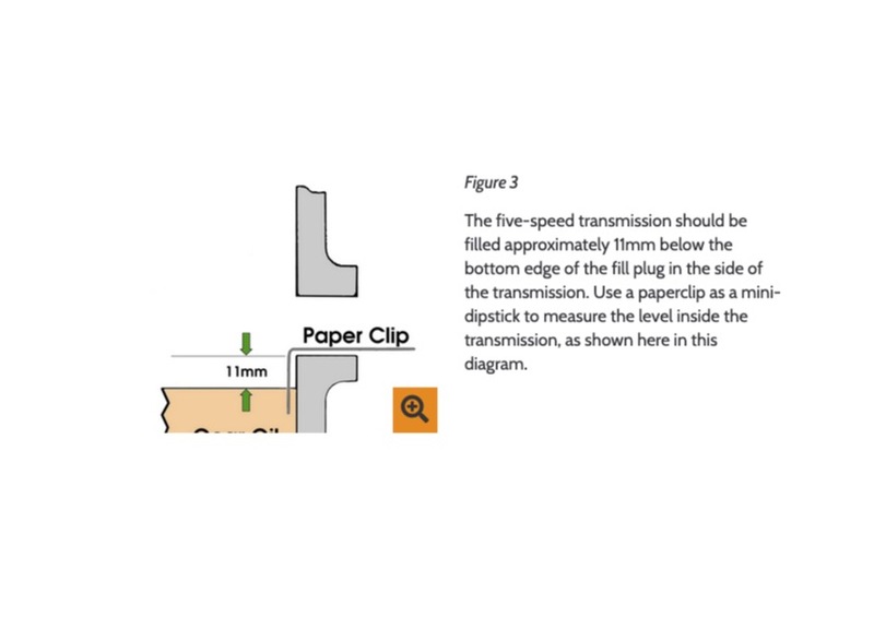

The oil level is very important to be right. On 5-speed, the level should be 11mm below the fill plug lower edge.
If the oil is overfilled, it is fairly common that some transmission oil seeps thru the oil seal at the transmission input shaft to the clutch bellhousing. On the bellhousing is a lot of opportunities to collect the small amount of oil before it leaks down to be visible.

You can fill until it drips out of the hole, no need for "11mm" below. Your oil might get too hot, but no need to corelate with your change. Is it the right specification, you should find an GL-4... oil that is equivalent to 999 917 546 00. I changed it to a fully synthetic 75W-90 GL-4/5 too and it works perfectly

You're right on 6-speed transmission, but on 5-speed it is on Porsche service manual as well as here at Pelican specified to fill only to 11mm below the fill hole.
Of course everybody can do to own car as pleases. I'll stick with Porsche Service manual instructions
https://www.pelicanparts.com/techarticles/Boxster_Tech/38-TRANS-Manual_Fluid/38-TRANS-Manual_Fluid.htm
