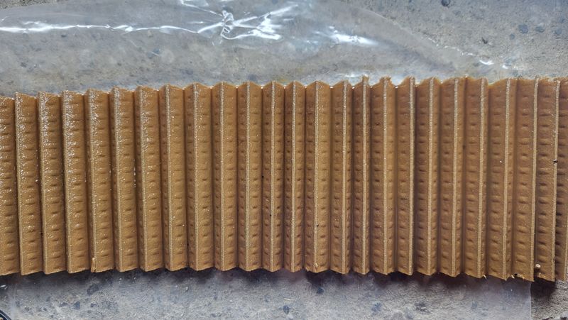

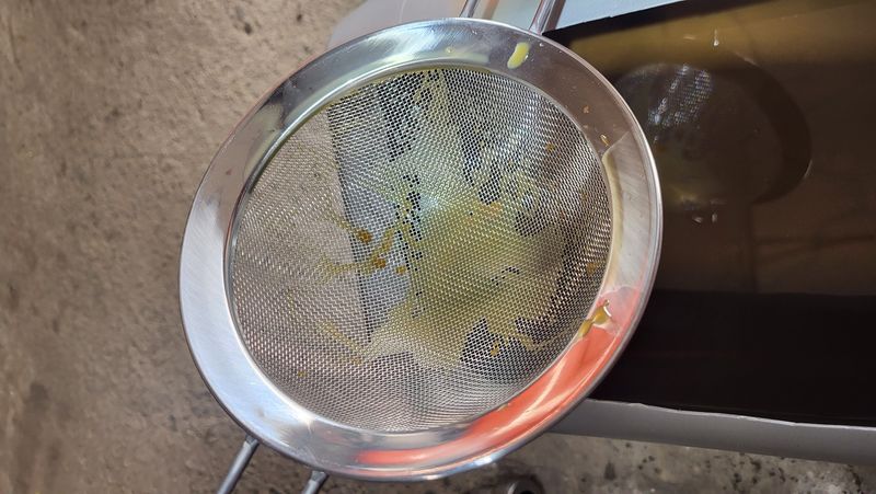

So, i just finished up in the garage. Car was jacked up after running shortly to get oil lukewarm. Oil was drained through a sieve into a clean container. After this the oil filter housing was taken off, poured into another container, and filter changed. Old filter was then cut open and spread out.
Result, no metal fragments what so ever. None, Nada. Not even a single piece of glitter.
The oil filter and housing also seemed mostly clean, except for a few really small pieces of brown plastic, as expected. The variocam pads are worn and breaking down, I know this already and the job is planned.:rolleyes:

Sieve i ran the oil through. Completely clean.

Oil filter

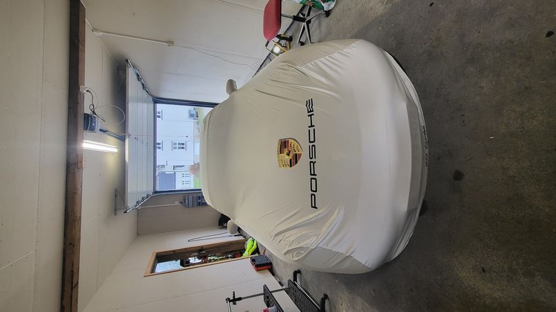

Back in storage
http://986forum.com/forums/uploads02...1744305626.jpg

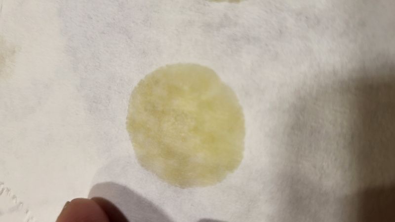

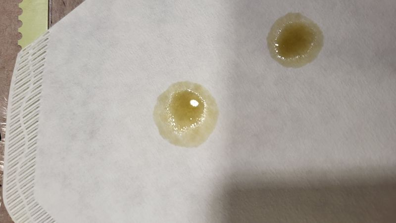

blotter test
Originally Posted by 997_986 (Post 666759)
While waiting for the UOA, you can do a blotter spot test with your oil. There are several templates on the internet with which you can compare the result.
https://www.youtube.com/watch?v=pdN-yWwJxtA
I did the blotter test on coffepaper just now. :)
After about 40 seconds the oil is absorbed outwards. There is a bulb of oil in center and a "wet" circle outside. Seems pretty normal, right?:rolleyes:
http://986forum.com/forums/uploads02...1744313690.jpg
After 10 minutes i checked back. All oil is absorbed already. I looked at the spot with a magnifying glass, and could not see any debris. So nothing worrying about this, right? Now i just wait for the oil report.
http://986forum.com/forums/uploads02...1744313748.jpg

997_986 04-11-2025 12:04 AM
First of all, everything looks good imho, but I would use normal paper and not a coffee filter, the coarse structure may make it difficult to recognise the boundaries that form...
Rob175 04-11-2025 07:23 AM
Looks good to me also. Suggest you drive the car since a hot engine will "boil off" any SLIGHT amount of condensation in the oil if given enough of a chance.
Obviously, that works with SLIGHT amounts of condensation. But if not "slight" I would investigate deeper. (any loss of coolant level?)

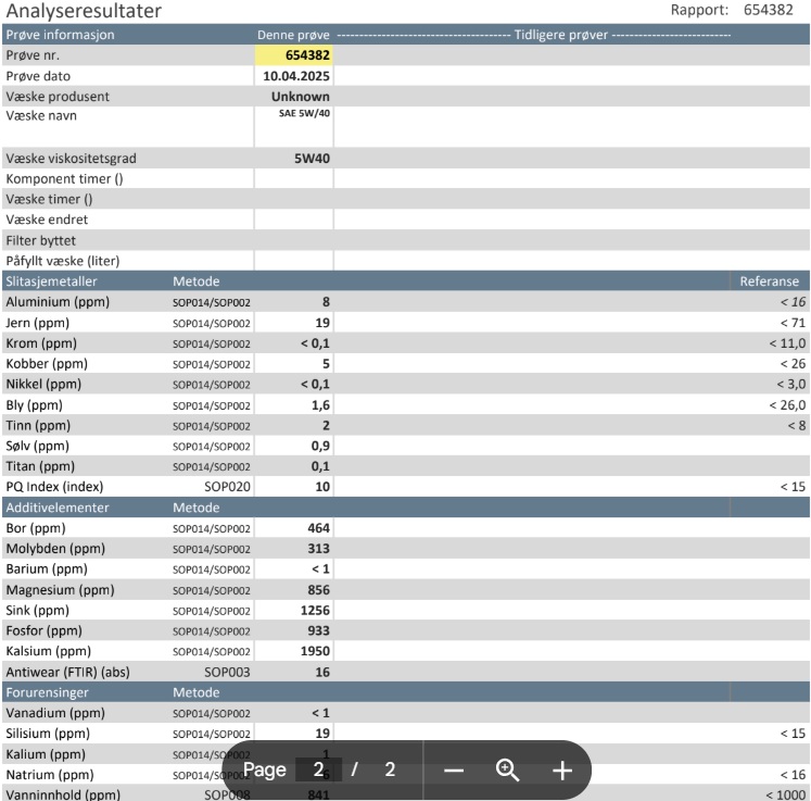

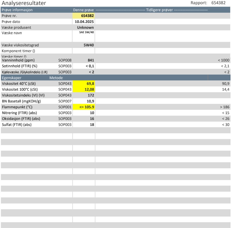

Delivered sample today at 11, they said i would get result by monday. But got the result before evening! GOOD NEWS! No abnormal wear metal levels! :D Reading results there is condensation in oil, but not very much. It does contain a bit too much gasoline thou. I cleaned the catch container with gas before i drained oil into it, but i dont know if that would make the oil thin.
Anyways I do not have a problem! But even thou test looks good, it does not explain why the oil looked weird. I will change the oil, based on looks. As my dad suggested after working on differrnt engines for a lifetime. I will keep an eye out on the value of aluminum in the oil thou, as it might be high for such a short runtime.
I want to thank everyone who has contributed with their time and effort to help me with tips and suggestions in this thread. Thank you.
The comment/report said the following (google translate from norwegian):
Comment
Missing information on specific oil in use, as there are several Mobil 1 3000 5W-40 variants.
The analysis (evaluated against SAE 5W-30 generally) indicates some gasoline present (low viscosity and low flash point). Requires that the sample be taken from operating hot oil (some gasoline will always be present, but this normally evaporates during operation).
The wear readings appear normal, no indication of abnormal wear detected. Water content
normal, no indication of possible coolant. The oil is somewhat thin, but this need not be
abnormal.

997_986 04-13-2025 11:10 PM
What kind of oil is it that contains so much boron and molybdenum? Very unusual. Additive? Otherwise the viscosities should be more or less the same as the fresh oil, or the remaining oil (which is 20% of the total filling quantity) was completely empty!?
Petecomplete 04-14-2025 01:57 AM
It's mentioned in the first post and some of my replies. The reason i drained off some oil to begin with, was to add Liqui Moly Ceratec. The boron oxide and moly is part of the antifriction package in ceratec, that supposedly reduces chance of bore scoring, and reduces metal on metal friction.
The oil itself is a porsche A40 rated oil: mobil1 3000 x1, 5w-40.
The viscositie is somewhat compromised by fuel/gas in the oil according to the report.
997_986 04-14-2025 02:56 AM
