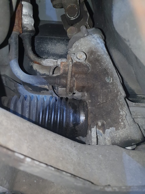

Today I 'inspected' the steering rack. I was mainly searching for the part number to ensure I order the right boots. Didn't succeed in that, got the 996 and a bit, but not the last numbers that actually matter.
Anyway, I noticed the driver side being dirty;
Attachment 23808
Having read that the main failure of the racks can be found by a boot full of power steering fluid, this did scare me a bit. I popped the boot off but found nothing but a greasy rack :)
I was now able to rock the tie-rods in different directions on both side. Passenger side, no play found, no noises, all good. On the drivers side I could get the clunk by rocking the tie-rod up and done (fore-aft was silent). It didn't sound like it was coming from the tie-rod itself. With the boot shifted aside I could see the rack (to toothed part) move along with the clunk.
So I guess I am looking at getting a replacement rack....

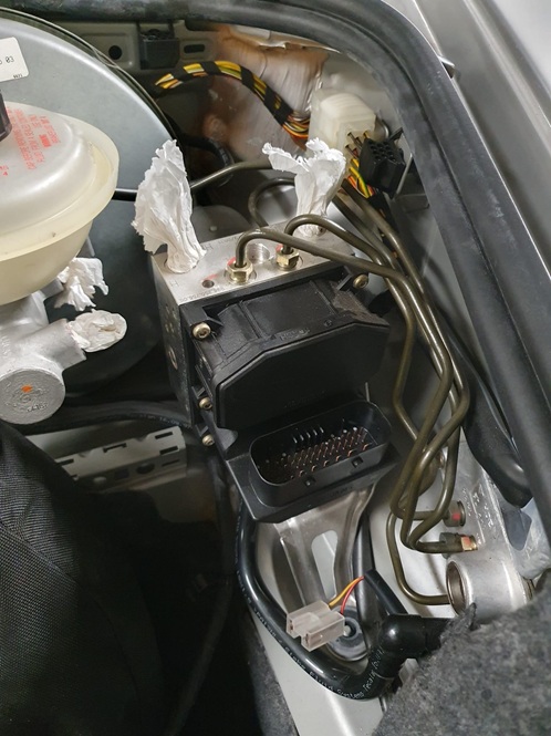

This is the ABS 5.3 unit still in the car;
Attachment 23810

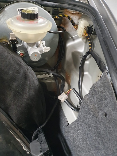

Then, taken out (along with bulkhead feedthrough block as I need one with the additional rear line)
Attachment 23811

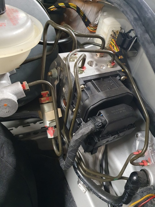

And the ABS 5.7 in the car (not screwed down, so it is still tilted a bit)
Attachment 23812
I also managed to take the single rear brake line and the T-union out of my car and replaced with the two rear lines from the wreck (along with union). Front brake lines mounted back as well.
It does seem like I will need to swap out the rear brake lines, or at least the right rear (which is the hard one). The nut on the brake line has a different thread than my old brake line. I removed these rear lines from the wreck as well today, but install will have to wait till the work on the front side of the car is done.
Next step is to finalize the two brake lines to the rear (tighten them, clip them in) so I can re-mount the washer bottle and headlight etc. Then I'll finish the front left side of the car with a new brake hose and the S-brake (disc and caliper).

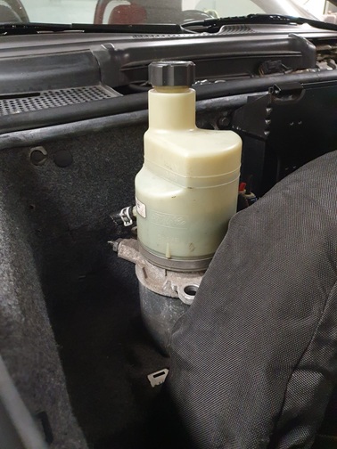

Meanwhile I ordered and received a Volvo power steering pump. Cheap and low mileage unit, so should be good. I'll probably give it a short test in the weekend to see whether it spins up.
So far, I don't think it is going to fit where I wanted it to:
Attachment 23814
Alternatively I could fit it behind the front bumper. I have all the hardware to install the third radiator there, but am questioning the effectiveness anyway...
I'll need to have a further look into this.

Mark, if you didn't find any oil inside the rubber boots, then the leak is from the viton o-rings that connect the metal pipes to the rack, these are not expensive and very easy to replace.

My point is that you may Not have to swap the steering rack and only have to replace the o-rings to stop the leak, awesome project, none the less :-)
