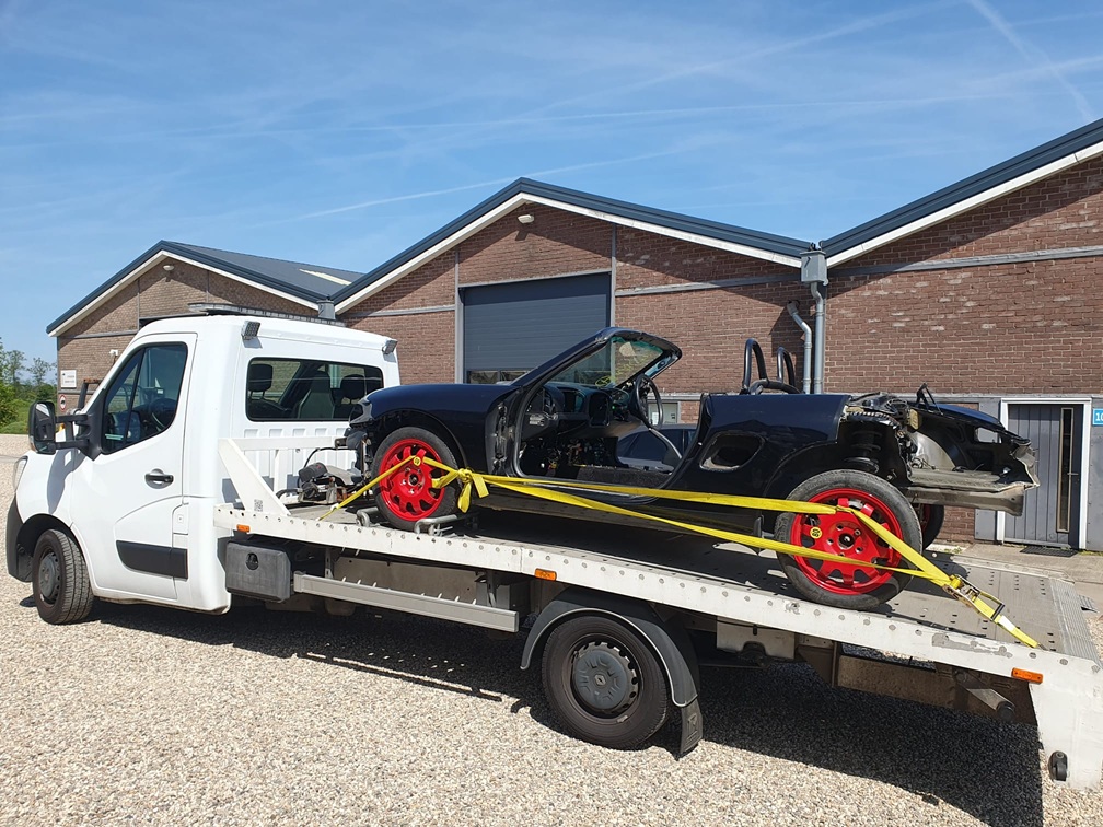

So, on to the carcas. As said, I was able to pick it up today. It was a 03 S, so has the right wiring loom and ABS unit for me to use. Also all cooling pipes (thicker than base) and radiators are on. Brake system is complete (I have the calipers as separate parts with me).
Some parts will go back in a few weeks and will be replaced with my own. Having them on the car now was easier for transportation and ensures no hoses are cut etc.
Rough plan is to transplant ABS and all associated parts coming winter. I might put the S brakes on as well. In parallel I intend to source my V8 and start the mechanical fitting part. Also I could move to electro hydraulic power steering.
For now I am finishing the car as it is. Final wires for the radio etc. will be soldered tomorrow so I can put the interior back together.
Picture to show what I picked up:
Attachment 23756

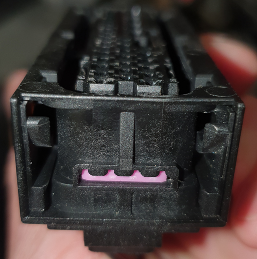

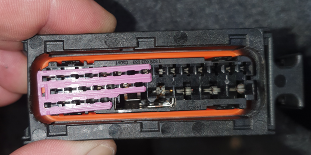

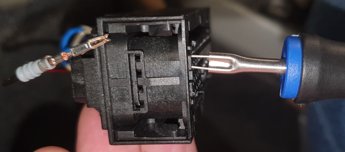

Big step forward today for getting the car back on the road. One of the things to resolve was getting the speedometer to work. The reason it didn't work is that the driveshafts are not compatible with this ABS unit (ABS 5.3).
So my plan was to repin the ABS connector and swap the rear wheel sensor providing the speed signal with a front wheel sensor.
There was a trick which took me a little time to find out. The terminals in the connector are held in place by a little strip as well as by the regular tabs. Two strips in total, one pink, the other white. These come out from the sides:
Attachment 23762
Attachment 23763
Once these are removed, the terminal come out easily using a removal tool;
Attachment 23764
Swapped the pins I wanted to swap and put the connector back together. I did a quick test and I now see an indicated speed when I turn the front left wheel by hand. Hooray :cheers:

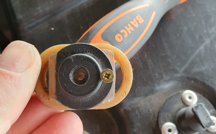

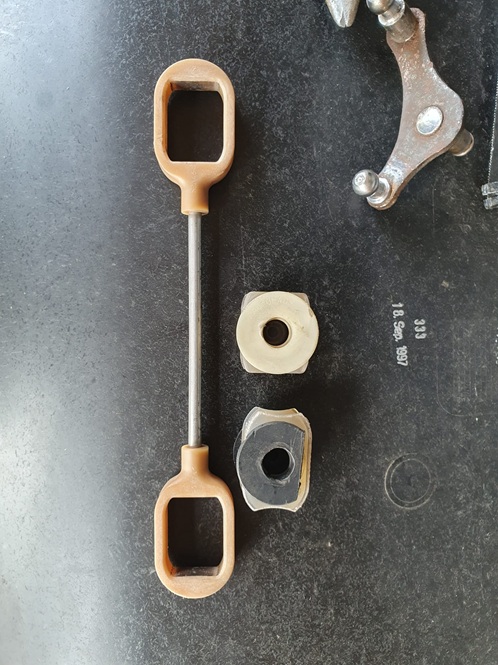

Marc_986 08-28-2025 10:22 AM
2 Attachment(s)
So, it has been a while, but some things have happened (besides a good holiday :) )
I checked the shift cable with a ball from the old 5spd gearbox. I could pop it off easily by hand, so no big surprise that it would pop off the transmission. So it happens that I still had the linking rod (which goes from the right side of the transmission, over it, to the left) around. Figuring that these sockets were unlikely to have been stressed, these might be an option. I first tried one on a ball and it was not possible to separate by hand, so quite promising. Then cut a side off so I could remove the socket.
Attachment 23806
Then the socket on the shift cable was removed and the better one put in place. I did put a small screw in to prevent it from rotating, but even without I doubt it would come loose that way.
Attachment 23807
I have done some limited driving, so can't conclude yet, but hoping this will last me a good while.
