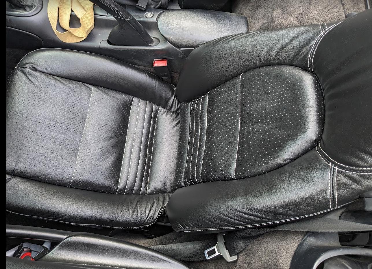

Stiglitz 05-28-2024 04:08 PM
Update on LSEAT Covers
one month later, time for an update.
Took about 3 weeks to get the covers. Received, very nice.
Took to upholsterer... well, you get what you pay for......A for effort, but that is about it.
Could have done better myself (famous last words!!).
Before I go looking for a new upholsterer, I gotta spend some time trying to make the seats look half-way decent.
Ended up seat bottom was also collapsed, so I had to fix that also....

Then my attempt:
It's not terribly noticeable on the pic, but it is much, much better, teh bottoms are tight at the seams, the tops are getting tighter... fixing the frame and teh seat support was kind of fun thought!Attachment 23626
elgyqc 05-28-2024 09:05 PM
A lot of those wrinkles will disappear with time... check the later photos in my thread compared with the just finished ones.
https://986forum.com/forums/boxster-general-discussions/81934-reupholstering-boxster-seats-lseat-kit.html
alexc0814 06-05-2024 10:54 AM
What'd you use to fix the collapsed seat bottom?
wiebuschk 06-05-2024 12:17 PM
Depending on the year' some seats have metal spring rod type supports and some have a sling or hammock type thing. The guy replaced the cover but didn't fix that? This is when you can add extra foam. A steamer and some hot sun will help take the wrinkles out.
