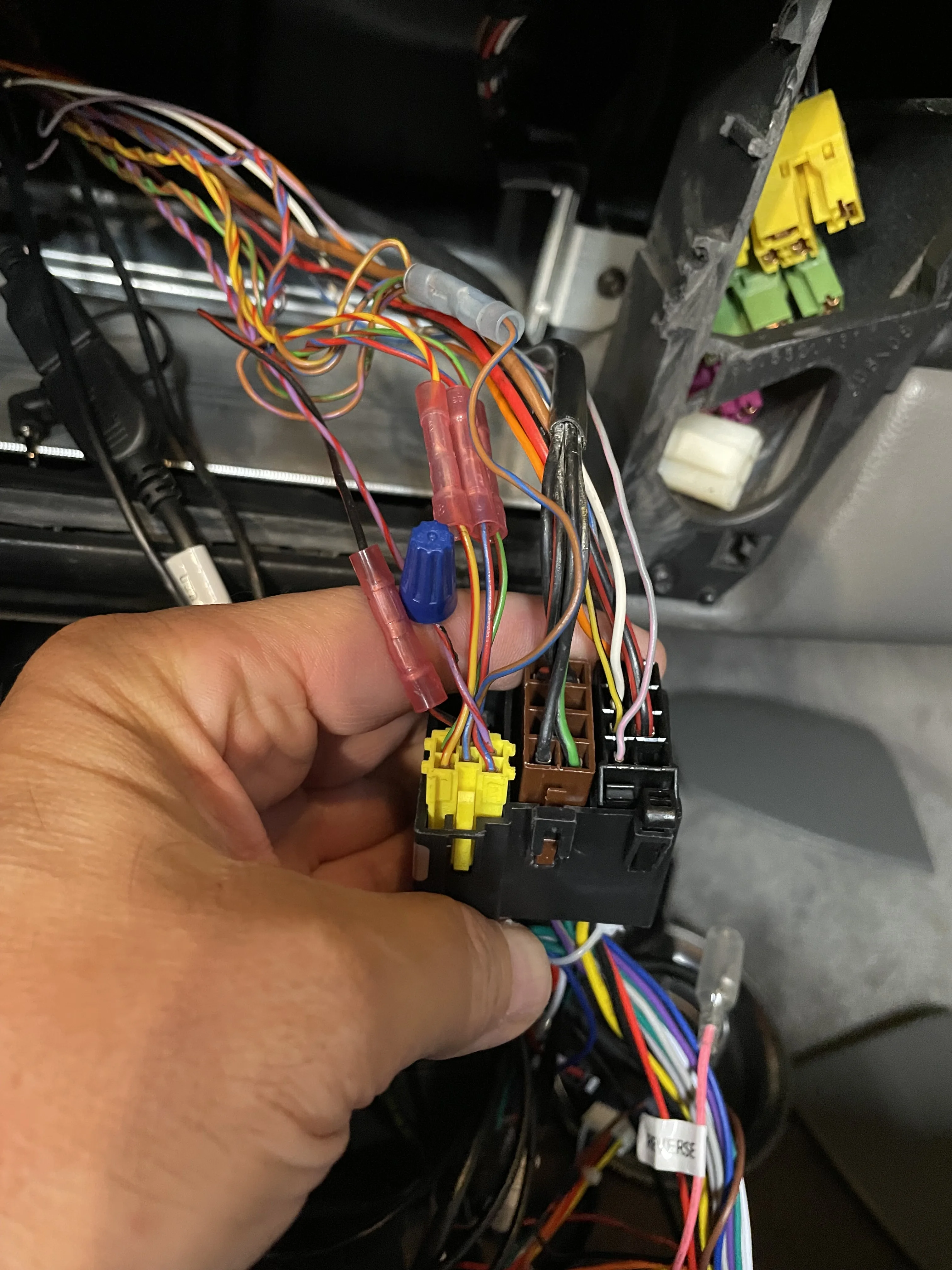

Mike, I am not near my car right now but there is a picture of my harness in my review on the website where you bought the unit. The biggest issue I had was I didn’t realize that the RCA cable jacks need to be connected to the back of the unit and the other end into the harness. Once I did that it was pretty easy. The RENNLIST thread had some good info on it too. I can get a picture of the back of mine early next week if you are still working on it.
You mentioned the RCA jacks plugging back into the head unit - which red and white RCAs did you connect? I have two male connectors coming from the car wiring harness side but four on the head unit side. Two are labeled AUX IN and two are labeled AUDIO OUT. I assumed audio out is the one I want but no luck..
Maybe a stupid question, but what is the brown connector from your review photo? Unless I dragged it out of the way when relocating my climate controls I don't have this one.
Lack of instructions has me scratching my head a bit I've got power to the head unit and it turns on and functions, but no sound comes out (the important part!) and I'm struggling to understand which cables I actually need to connect and which are extras or unused in my specific case (I have a 2000 S, so no Bose and no MOST but I do have the decklid speakers w/o the rear sub).

You don't have MOST so no worries there. Hopefully whoever installed your HU didn't get rid of the OEM wiring harness. If you have a "subwoofer", it is your door speakers.
If you look on the site where the unit is sold, you will see my review with a picture of my connection. I bought the one with more memory, it wasn't much more. I always figure more RAM and memory is always a good thing, but I have no idea whether or not it makes a difference but I will say my unit is very responsive, YMMV. As far as GPS goes, since you have an iPhone, you will be using your GPS in your phone. I am very happy with this unit, it looks great and works great! In fact CarPlay on this HU works better than the unit in my 2022 Honda Ridgeline.
