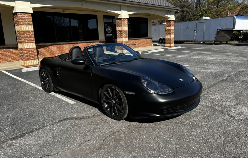

Haha fortunately I’ve never posted my car and had any smack talk about it. Seems like the car will be able to be fixed and not totaled out. Bill is $6300 but covered by insurance. I’m planning on just driving it like I have been, it’s been a good car with a few hiccups here and there. Needs some rear wheel bearings and the rims have been bent which has been bugging me so I’ll want to sort that out. Maybe some 18 inch turbo twists would look cool.
I did a compression test like two years ago and if I remember correctly it was 160-165 psi all the way around with the throttle plate closed which from whatever I was reading at the time looked good.
