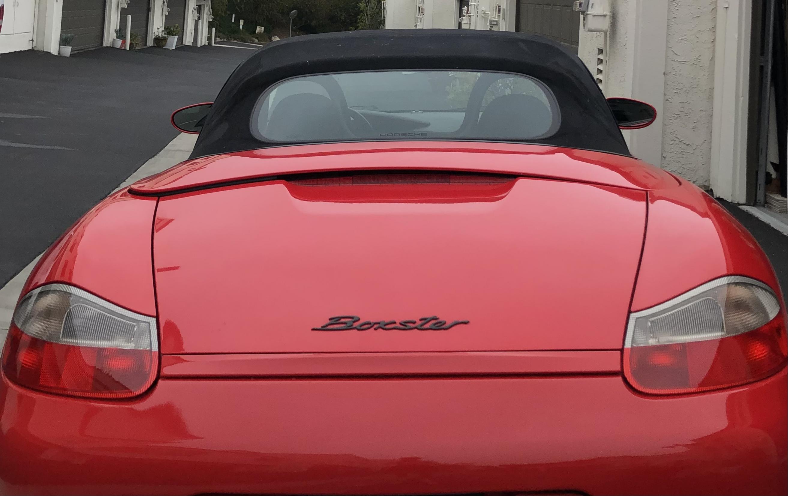

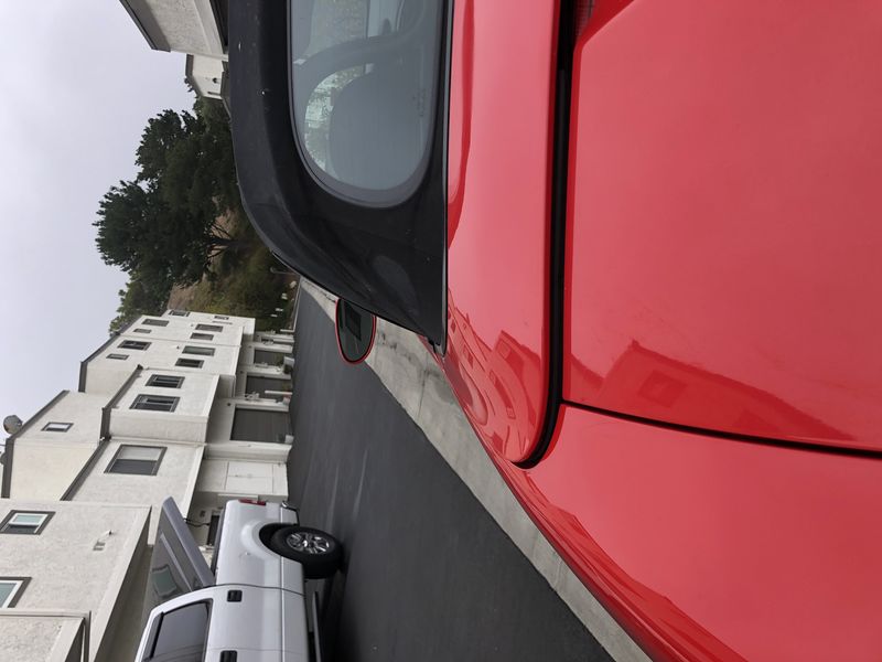

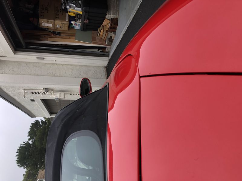

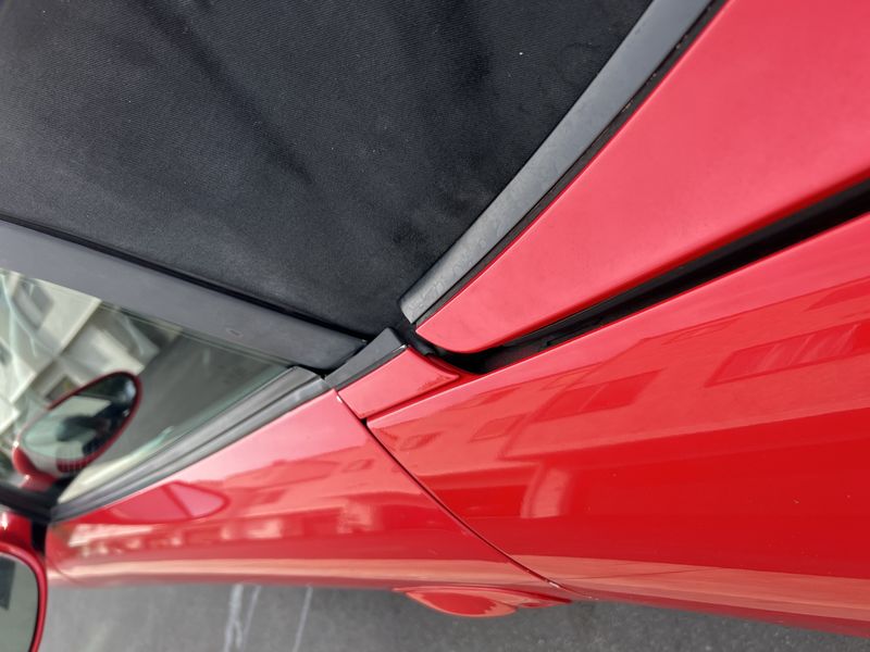

Hi everyone. A while back I had an 03 convertible top put on my 01 boxster. All was well until one of the convertible top motors went out a while back, so I took off the motors and converted to a manual top. As it sits, the convertible top clamshell is uneven, it's higher on the driver's side than the passenger (see pictures). I've done a lot of research but can't find a fix. When I push down on the driver's side it goes down but springs back up when I let go. I don't know if it's a problem with the top itself, which it looks fine to me, or with the clamshell. The driver's side is like pushed inward and I can't tell if it rubs into the top or now. It's starting to really bug me lol. Also when the convertible top is down, the whole clamshell sticks out like 2-3 inches, but that doesn't bother me as much because I rarely drive with the top down. Thanks everyone!!

I had this problem. Fixed it by taking the clam shell off and bending (twisting) it back into shape. After removing it I set it on the floor. It was obvious how it needed to be twisted so that it sat level. Very easy to do.

Hey everyone. Just thought I'd add a little update for anyone in the future that may have this problem. Thank you to everyone who helped. For years I've been stumped by this issue and thought about all the possible solutions. I didn't really consider that the clamshell could've been bent until going through literally every option and inspecting every part of the convertible top. My final go at it was today and I decided to take off the clamshell and see if it was possibly bent. Turns out, aczyzewski was right, it was bent! Thank you aczyzewski for your help, and I'm mad at myself I didn't try it earlier.
To anyone with this problem, removing the clamshell was easy; there's simply 3 10mm bolts holding it onto the convertible top arms. Once you get it off you can put it on the floor and press all 4 sides to see if there's a bend. Like previously mentioned, it should be pretty easy to see how it's bent and how you can bend it back so all the sides are flush on the floor. Then throw it back on and you're done!
