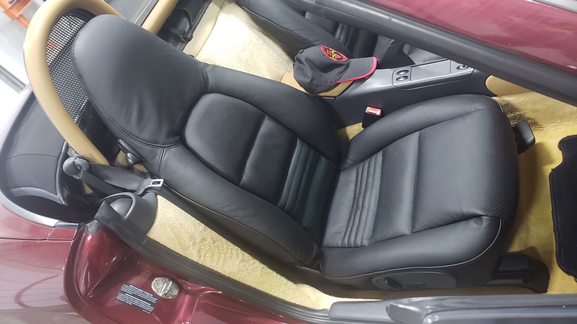

A lot of work for sure. Do you think a lot of those wrinkles will work themselves out over time? Do you think the wrinkles come from the lock of experience at upholstery work or is it the product itself?
01-24-2022, 12:41 PM
#3
Location: Dahlonega , Georgia
Posts: 1,362
Interesting comment about the passenger side fitting tighter . Because the driver's side is generally used much more than the passenger side I wonder if the foam was less compressed on the passenger side ?
I was wondering if maybe a thin layer ( 1/2 " ) of additional foam on the driver's side may have helped with a tighter fit . Common sense says it would have helped .
I think with some seat time 😁 and some adjustments of the zip ties you will get them tighter. . I think you did a good job . Please try to update maybe in 6 months to see how they look and are holding up .
Last comment/question . What if anything did Lseat recommend for conditioning and treatment of the leather ?

This is a relatively inexpensive kit so it would be surprising if it would be a perfect fit. From what I have seen there are always wrinkles, perhaps fewer if the installation is better. But it is possible to remove some of them using heat, there are lots of videos on Youtube. My (inexperienced) feeling is that it would be better to let the leather work a bit before doing anything. Perhaps some of the wrinkles will go away and others will appear. The vaste improvement already means that I can live with a few imperfections for awhile and try to make them go away in the summer.
Grant

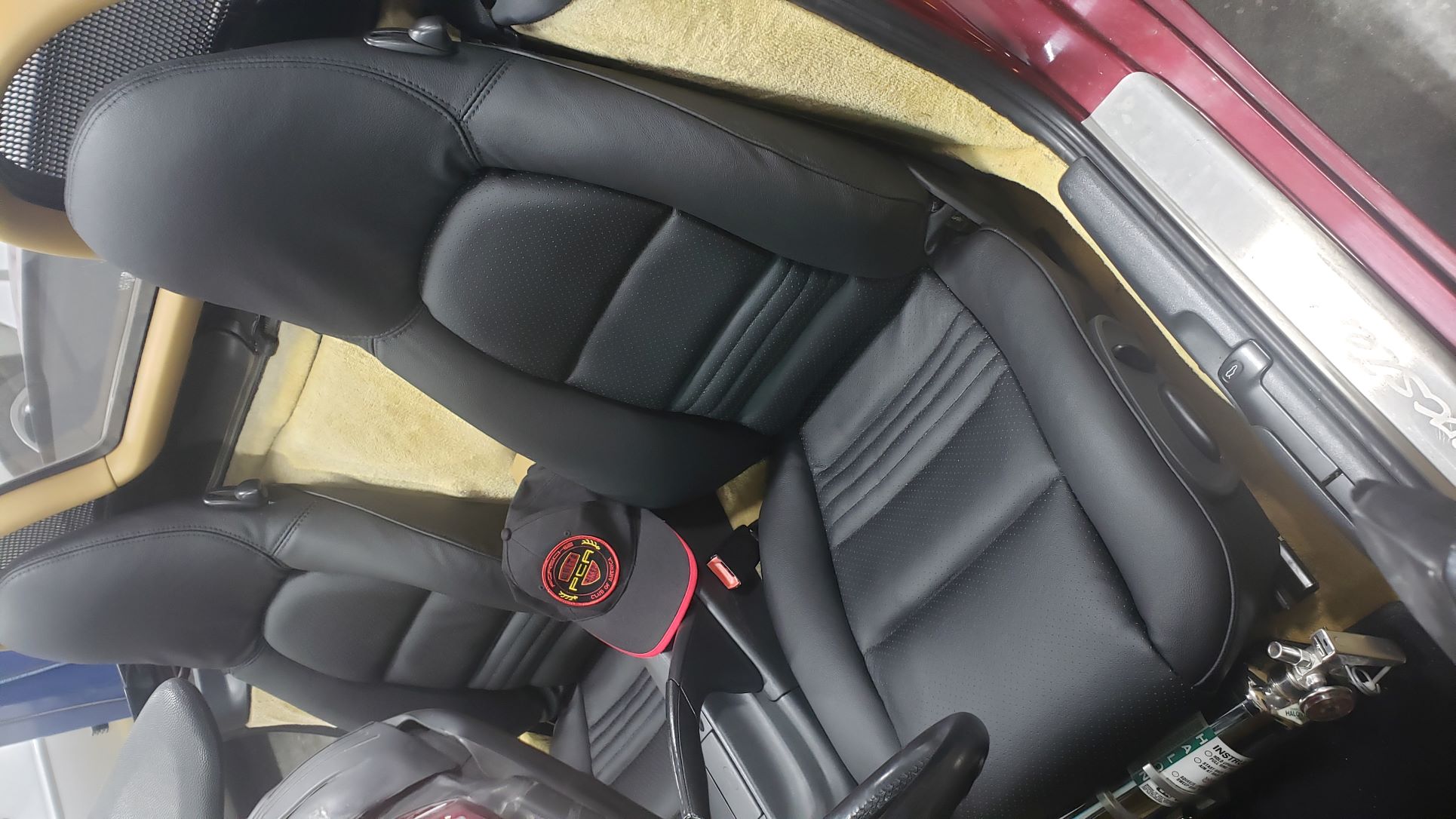

To disconnect the wire that goes to the seat back recliner switch you slide this little cover off, then slide the connector out.
Here is the passenger seat finished...
... and the 2 seats installed.
The difference in colour between the original "savana" and the "lark" inserts is noticeable but doesn't clash too much because they are not side by side.
I am happy! I'm curious as to how they will look after being used a bit.
Grant

Those are just cloth covers you put over the seat frames? Thats not leather is it? Someone has to say it, but the fit of those are horrible. Kuddos for you for trying to take on this project, but there are times when you pay a professional for a great result.
01-20-2022, 11:09 AM
#15
Join Date: Sep 2018
Location: Laval QC
Posts: 857
Well you said it... and I disagree. If I had enough money to pay a professional a couple of thousand dollars to do the seats of a $6000 Boxster... I wouldn't have a $6000 986 which I do all the work on. Compare the original seats and the covered seats, which is horrible? For me it is a great result given my resources and what the car is worth. In the summer I plan to do some work on the wrinkles to improve the fit.
By the way, the covers are all leather, the originals had vinyl on the seat back and the cushion sides, but the Lseats are leather there... which makes fitting it bit more difficult becuase the original vinyl is stretchy. Perhaps the lack of stretch doesn't help eliminate the wrinkles.
Grant

Good work elgyqc. Most of the wrinkles should flatten out as you use the seat.
A good set of Hog Ring Pliers makes using the metal rings a lot easier - no harder than zip-ties and in my opinion a better choice. ( Knipex Pliers) New rings are inexpensive and easy to work with. I got a box of 100 1/2" rings for a few dollars.

You do a good job getting them on. Using hog rings would have given you a somewhat better fit but in the end your seats look like the others I have seen from Lseats. Their templates just aren't that good in my opinion and the fit isnt as tight as it should be. It will get a little tighter in the summer, but not enough to look wonderful. A pro wouldn't have been able to get that kit in too much of better shape, it's the covers more then the install.
All in all, great job. Only so much you can do with a product that isn't that great to begin with.
I went down this route and in the end decided to just put in some 987 seats that were in perfect condition. Was around the same price but the install was so much simpler...just remove the old and install new, plus the 987 seats are all heated so now I also have heated seats for the same price.
