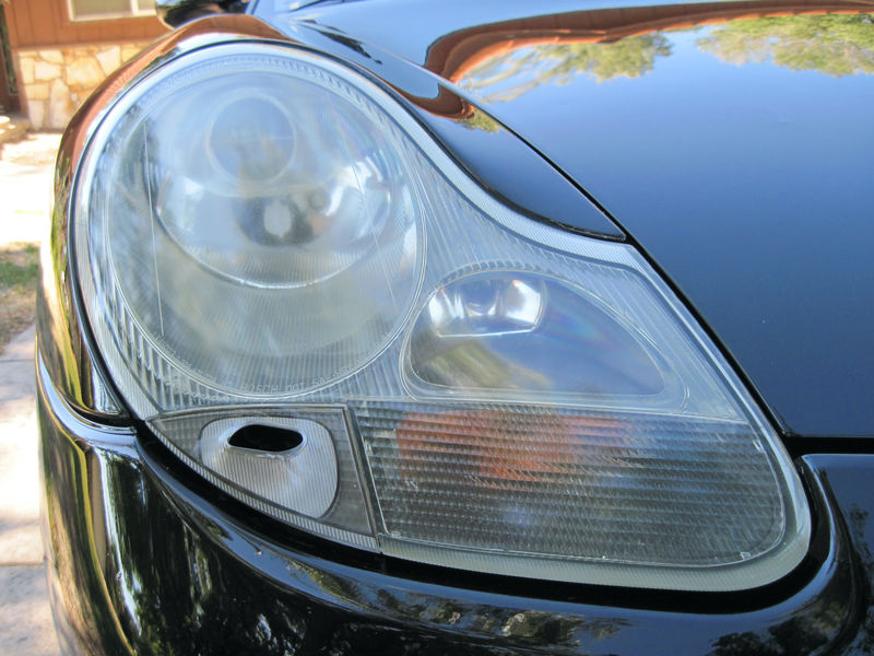

Ok so I know the Litronics can work with my 1997 Boxster. It's plug and play with the exception of the auto levelling feature. Not willing to spend the $$$ to make that work. Sounds like it's not that big of a deal. This is not a daily driver nor will I be doing a lot of night driving. Does anyone know where I manually adjust if required? Is it on the headlight itself. Also many are equipped with that washer hole. My standard lights don't currently have that. Does that mean I will have to replace those corner pieces with ones that don't have the washer hole?

I need to replace my lights because the reflectors are cracked and yellowing. A common issue.

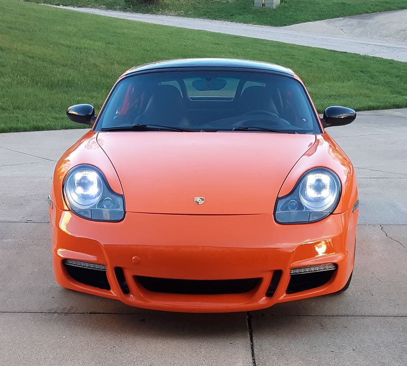

They are really easy to adjust. Just need an allen wrench. Check the owners manual or Utube. I had factory xenons, really not that great, and replaced them with retrofitlab retrofit kit. Much better than factory xenons and not that expensive, $300 approximately, IMO.

These look really good. But I am not willing to open up the headlights I have and retrofit.
