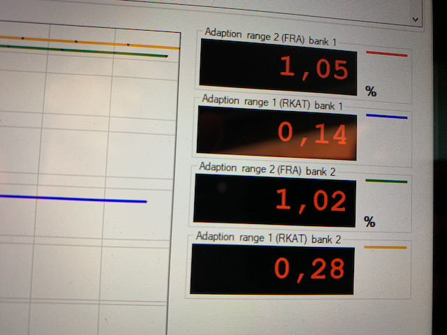

Trying to understand more about fuel trims... then again, in my car the idle is spot on, so hopefully highjacking the thread causes no hassle here...
This image here is from FlatSix / Jake Raby video and those figures look to be very much uniform:
This image below is from my car (2001 986 with 2.7) and the figures are way off compared to above FlatSix values:
Are my car's injectors shot or something else there messed up? The car runs nice and has not issues for loss of power not anything else. What can cause such different values that whet Jake Raby's figures show?
All help is most appreciated

First you are comparing dissimilar data.
The Raby info is for Adaptation Range 2 (FRA-FRAU) for banks 1&2
Your info is for Adadaptation range 1 and adaptation range 2 (FRA RKAT) for banks 1&2.
Your comparing apples to oranges.

As Blue pointed out, you are trying to compare 2 different things. Might be looking at an issue that isn't really an issue at all.
Correct.
If the car runs fine has good power decent fuel milage, and no codes then the car is performing within design parameters.
To look at a screen shot of something like Fuel trim data and think oh this is great because it comes from so and so is pointless. Without surrounds data like coolant temp. RPM, Engine load, Throttle position sensor data, O2 sensor data. That screen shot is meaningless.
In most conditions to look at a single frame of data of any type without surrounding data is a waste of time.
When looking at fuel trims as described by something like Durametric they are broken down into RPM ranges. Idle, cruise, and upper RPM. IIRC fuel trim or adaptation is figured or calculated differently for each range. So you can't compare fuel trims from idle to fuel trims from cruise or mid range and have it make any sense.
Also if your at one RPM say Idle how could you have fuel trim at another RPM at the same time.

to add to that, just because it may "look" different doesn't mean it's bad either. things need to be within tolerances which can be found within the FSM.
if it isn't broke, dont look at it. lol
