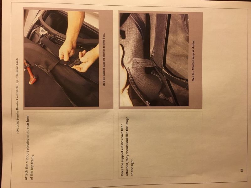

I'll give this a try, however, my top does not have that piece of material shown in photo #1, however, there is a 6" flap of material near the seam by the rear window. I attached a piece of elastic to that and wrapped it around the front frame pillar thinking that would work. FAIL!!!

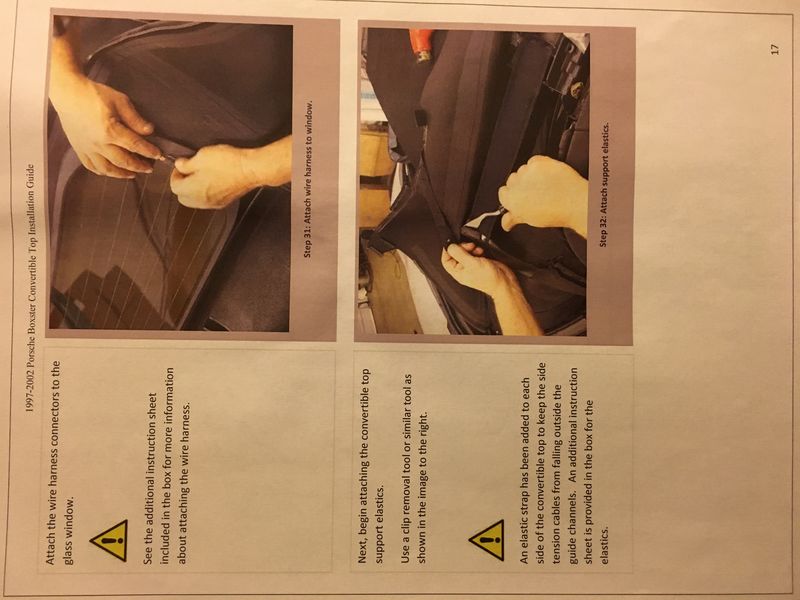

I see your car is a '99 and mine is an '01 so I probably will not be much help. I just replaced my top in October with a glass window and have the instructions from the manufacturer. I will try to post a couple of the photos that illustrate this area when I get home tonight. However, mine clearly had the rubber tab on the frame to which the cloth strap attached. The strap had a hole which, when the rubber tab was peeled back from the frame, pressed over one of the plastic studs. The flap was then tapped back into place and you were done. The '99 obviously had another way of pulling the cable back in line when the top is raised. Without this "assistance" I think you will be hard pressed to get a consistent closer.

Here are the photos I promised. Probably will not help much and I apologize for the quality. My top was also an aftermarket top from AutoTops Direct. It took me about three days to remove and install but i took my time. I have to say it fit like a glove with really no issues at all and it did include the strap which my OEM did not have. The OEM used simple Velcro straps around the frame to guide the cable. As 10/10ths states I would contact the top manufacturer and see how they recommend solving this issue. Without those straps I don't see how you can consistently get your cable to fit inside the frame like it should. Good luck...
Jgkram is offline   Reply With Quote
