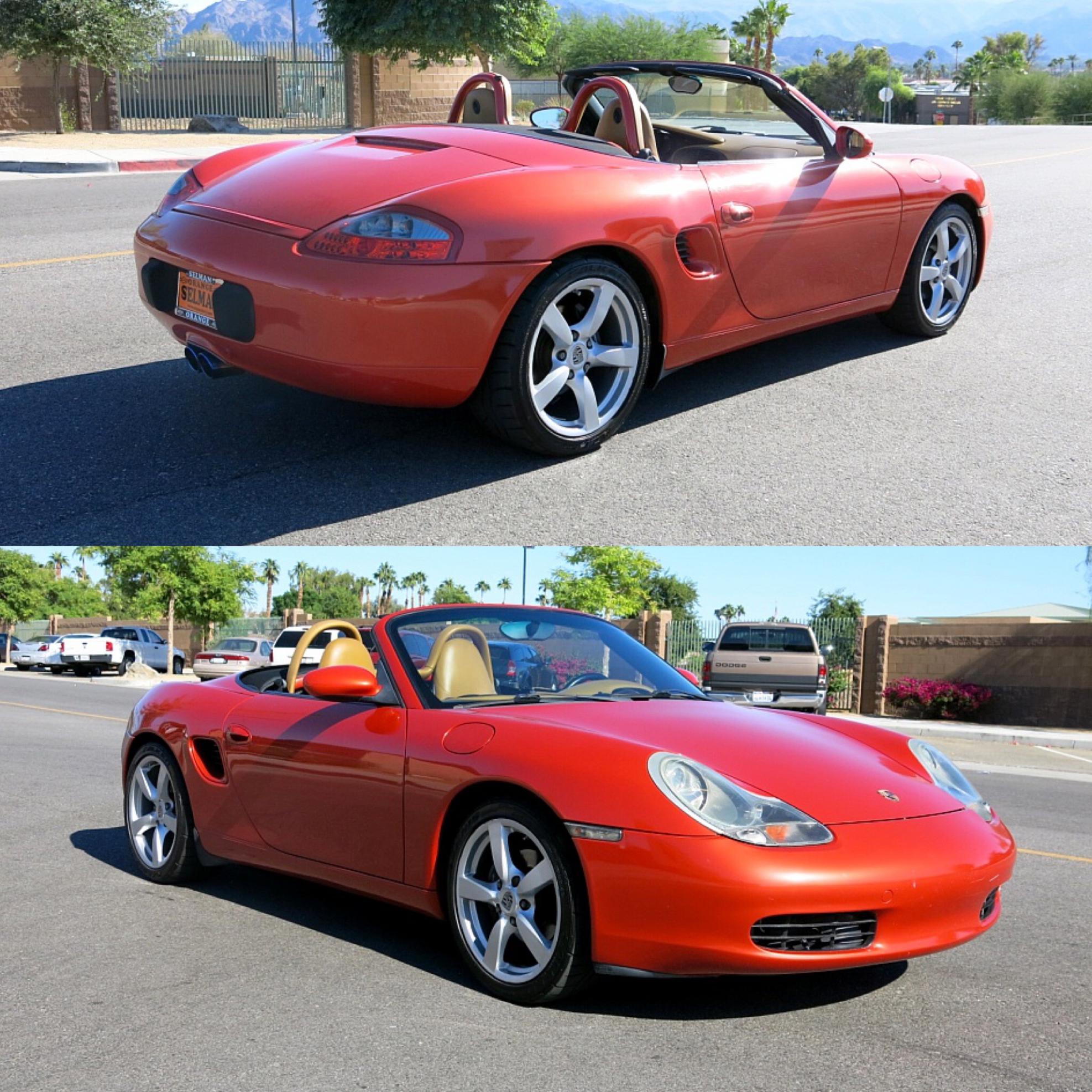

I'm still seeking tips on how to get my right brake light replaced. I've gotten conflicting information by my mechanic and Napa. I just need guidance on what to buy. The lens works with the exception of the brake light. We opened it up and the bulbs are very Tiny and connected by a harness and blue/red wires. It's not as simple as changing a bulb. I don't want to fork over the money to buy the entire lens when 1/2 of it works. Can you guys please point me in the direction of where I can get the correct part for my car?
it's a 2002 Boxster base. The lights are shown in the photo. Any help would be really appreciated.(it's the very center light on the right hand side) Thanks guys.

There is no part or bulb to replace. The control module inside the unit that powers the LEDs (the tiny bulbs you mentioned) has failed...common for these Dectane LED tail lights and there is no replacement other than replacing the entire assembly.
Your best bet is to swap out the tail lights for a normal OEM set.

I bought the new assembly only to find out I now need the OEM bulb holder. And bulbs.
Any advise on that?
Any advise on that?
When I purchaed my car one of the rear assemblies was challenging me with a bulb that would spottily work. Not wanting to diagnose... bend metal to ensure a solid connection... I purchaed a new one... and have the original in a box.
It's yours. I forget which side it's from, but you can have it. I'm down the hill from you and east. 92262ish. Let me know if you'd like it.
