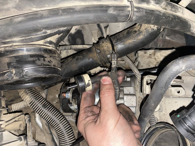

I am replacing starter, and now I found this cable and I don’t know what it is and where it goes?!
Please help! Thanks

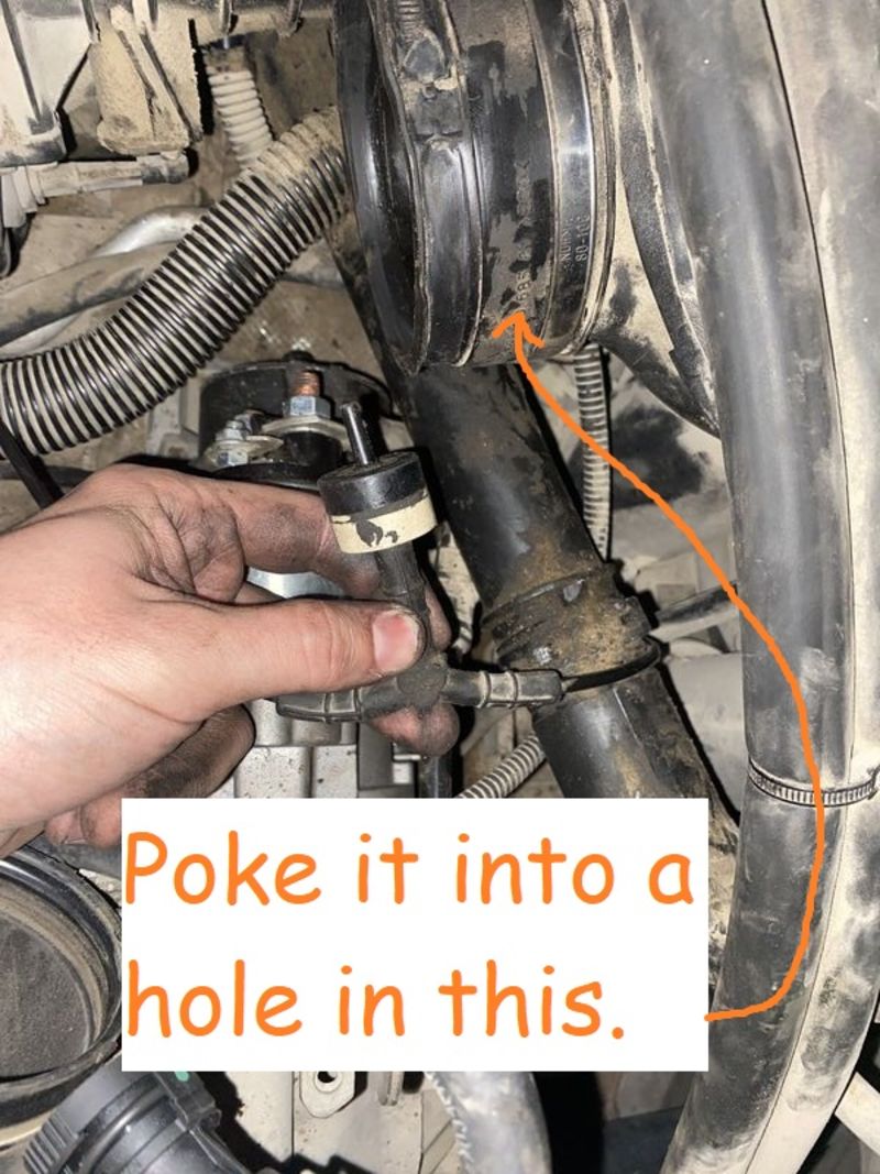

That is the vacuum tubing (check valve) for your secondary air injection. It goes to the rubber sleeve on the intake cross-tube. Look for an appropriate sized hole and make sure the rest of the tubing is still intact and connected.
