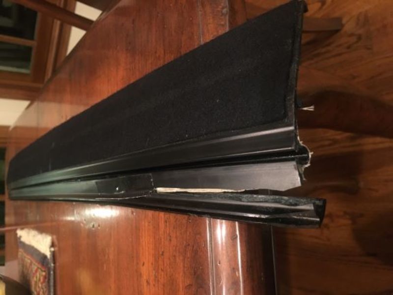

Here are a couple of photos of my cracked Top Retention Strip. As I said earlier, when I removed my top it fell into my hands in two pieces cracked completely down it's length! I tried to reassemble it using fiberglass but upon reinstallation today it cracked in another location. Just too brittle... Anyway, thought you might like to see what you might be in for when you replace your top as I'm sure most of us are getting to that point by now.
This piece sits on top of the roof frame above your head. There are two channels on top. One for the head liner and one for the cord on your new top.

To anyone else who is curious about this part; Seeing the pictures that jgkram posted I realized that there is a difference from the part that I pulled from a 1997 top - There is no second channel to insert the liner, just one for the top. If you do buy one of these for a top that you intend to have a liner in, make sure that it has the second channel.

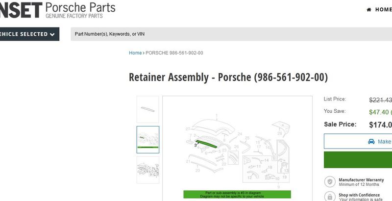

What I found: There IS a part number 98656190200 for Base and 98656190201 for S. No variation for model year. No idea what's different. You may want to ask the vendor if it supports the roof liner and about return policy just to be safe.
Pelican Parts does have them available: https://www.pelicanparts.com/More_Info/98656190200.htm?pn=986-561-902-00-OEM

About the time he found this information, I had called the local dealership. I too suspected this was the part but the exploded view is so sketchy that even they could not confirm this was the part. I have decided to order the part from Sunset and will post a photo when it arrives. For any interested, I ordered my top from Autotops Direct and the part appears to be really well made. A local installer also confirmed that the tops are of good quality as they have installed several. I will post some photos of the process and let you know how it goes in case this is something you are facing.

I confirmed with Sunset Parts that the …-00 part is for a retaining strip without the second channel for the head liner and part number …-01 is for the one with the second channel. So if you need to replace this in the future and every want to add or already have a head liner you need to order the 01 part. Rgds
