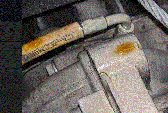

Old 08-26-2020, 03:32 PM   #9
Join Date: Mar 2017
Location: Massachusetts
Posts: 62
Found my oil leak or at least one of them. This after the IMS work I had done.
