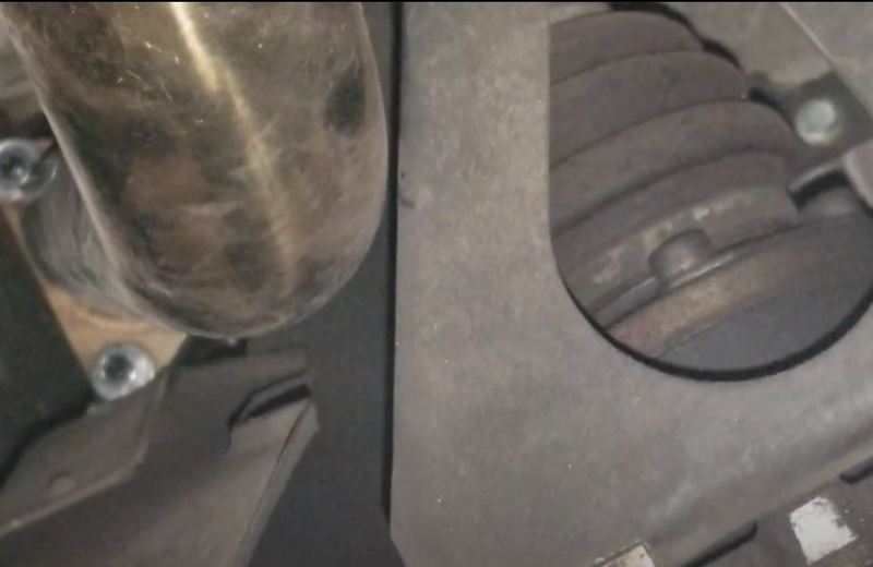

https://youtu.be/mO3-TtcMO7M
Here's a quick look at the rear end. The transmission mount arm and the midpipe are close, but there is a small gap. I'm thinking it could be the top bolt of the header-midpipe flange as well, since it's a tight fit up there.

Here is a screenshot from the video showing the gap between the midpipe and transmission mount bracket on the drivers side. I will check out the top flange bolts between the header/midpipe next time I am under there as well, that was the only other tight clearance I can remember.
