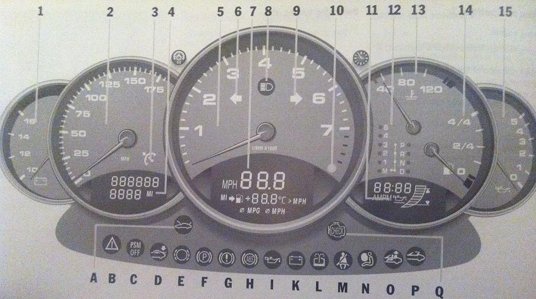

I have done this very thing on my 2000 S.
You are going to have to run one of the wires from the new harness to the instrument panel. This wire powers the cruise control indicator bulb when cruise is active.
So you will have to remove the instrument panel to get to the connector you need to run the wire to.
While you have it removed shine a light at the back of the instrument panel.
you should see the cruise control icon at the far right side of the panel.
Put the correct bulb in hole (if absent). light should be good to go

Ah! Thanks PaulE and blue62. I was looking in the wrong place for my cruise indicator light!!
I was looking for #3 in this graphic:
(Yes, I know it’s not exactly my cluster, but it shows the gauge face where I was looking)
It will be to the right of the top retraction Icon. Straight above the letter Q in your screen shot.

Thanks!
