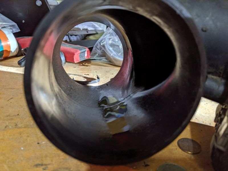

One way to check the vacuum is to open the oil cap with the engine running, which brought me to the following new discovery / question:
Does a oil - air separator fail suddenly?**** When I cleaned the throttle body I noticed a decent amount of oil in the intake plenum (see pics).**** Now I am (all of the sudden) noticing a large amount of white smoke on startup and when I took the oil cap off a pretty loud whistling noise which I read is caused by the extra negative vacuum experienced during the failure of the separator. Prior there may have been small amounts of smoke on super cold starts, but nothing like what i have seen in the last couple of days.**** I really had not noticed anything before my issues started and it seems like a rather sudden failure.**** I instincts tell me something like an oil-air separator would fail gradually, with more smoke appearing at startup, etc.**** Either way, could it be the oil in the intake that is causing my 'sudden' loss of power in the low revs and idle issues?**** I would think oil being sucked in to the combustion chamber would have a negative effect and possibly be fouling my plugs too.
Here is the oil i found when I cleaned the throttle body:
and here are before and after pics of the throttle body
bg305 is offline   Reply With Quote

Yes the AOS can fail suddenly and sometimes catastrophically. I'd say it's time to change yours. Most vacuum leaks I've found by just listening for them and poking around. The oil filler tube is the most common cause of a vacuum leak that I've experienced, but any of the many tubes on these motors can cause a leak.

Your AOS has failed. Replace it. With that much oil you should be seeing smoke on startup and most likely while it's running.

Well as I stated it was only a guess. But look at the condition of the throttle body butterfly. Does it look like oil dirt residue??????? or just dirt???? Not sure myself. But I believe it is upstream of the oil in the intake. So like I said I am only guessing.
I don't know when last your oil was changed, or your air filter (didn't again read this entire thread) but I'd suggest it's just oil. When I purchased my car a couple years ago I chose to remove the air intake... and what I saw mirrored your "dirty" pic and with more oil. I pulled the throttle body and the asociated tubes... and they had a fair amount of oil. I, too, pulled the MAF... cleaned it up.
Cleaned it all up... put it back together and, not long thereafter... installed the OEM AOS.
Pulled off the TB about a month later (and after the new AOS install) just to double check... and all was good.
Your TB looks clean now... you'll be all good. You'll find that as more you read upon these pages you'll begin to "know" better your car. Ask questions for those answers you can't find and you'll be a Porsche mechanic in no time. Maybe not on the same level as the "Masters" who serve as outstanding resources... they Rock.
