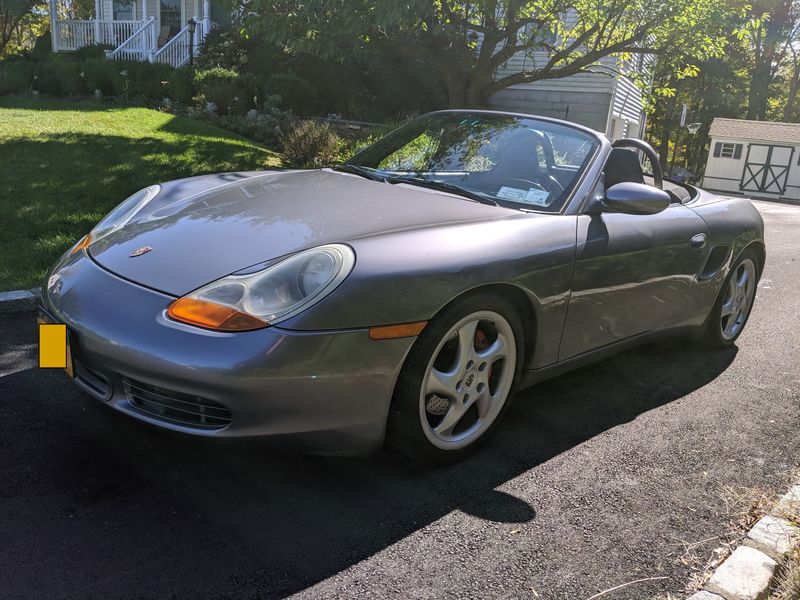

Celebratory pics of the car (from last week).

Always great when thing come together.
Nice looking car
