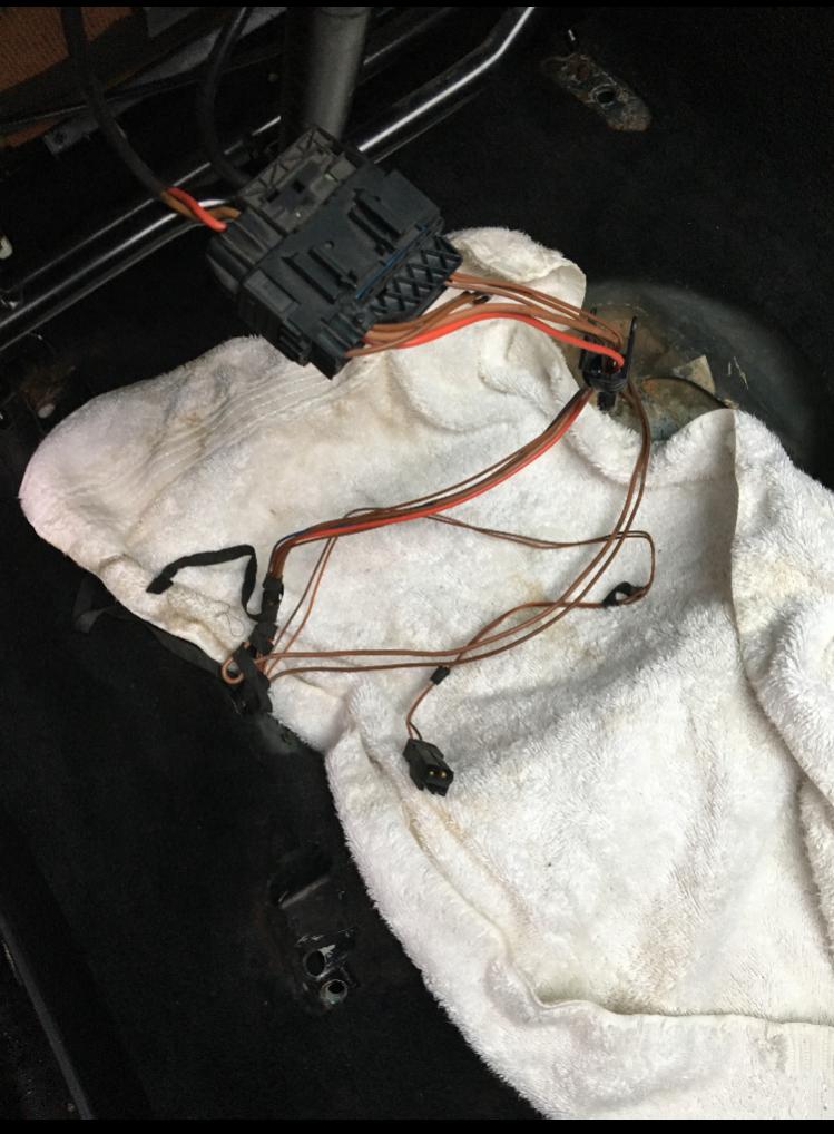

I removed passenger seat from 986S and disconnected harness with tab. When I put the seat back in a week later, this reconnected fine but I now see a ?new? connector and wires, and I have zero recollection of detaching this (nor where it can from). A photo of the two brown wires and the loose connector is attached. Can anyone help me to ID and tell me where the other side connector is located?
FYI I do NOT have heated seats.

I just looked at a car with the seat out. That 2 pin connector is taped to the wire bundle. I'm fairly certain it's for the passenger side airbag deactivation bar connector. Just secure it back to the other wires with some tape or a tie.

Yep, it's for the airbag deactivation bar.

Zip tied off. Thanks!
