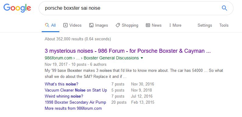

If the whistling happens on a cold start it is the secondary air injection pump, SAI. It is a pollution control device that is on for a short period as the car warms up.
