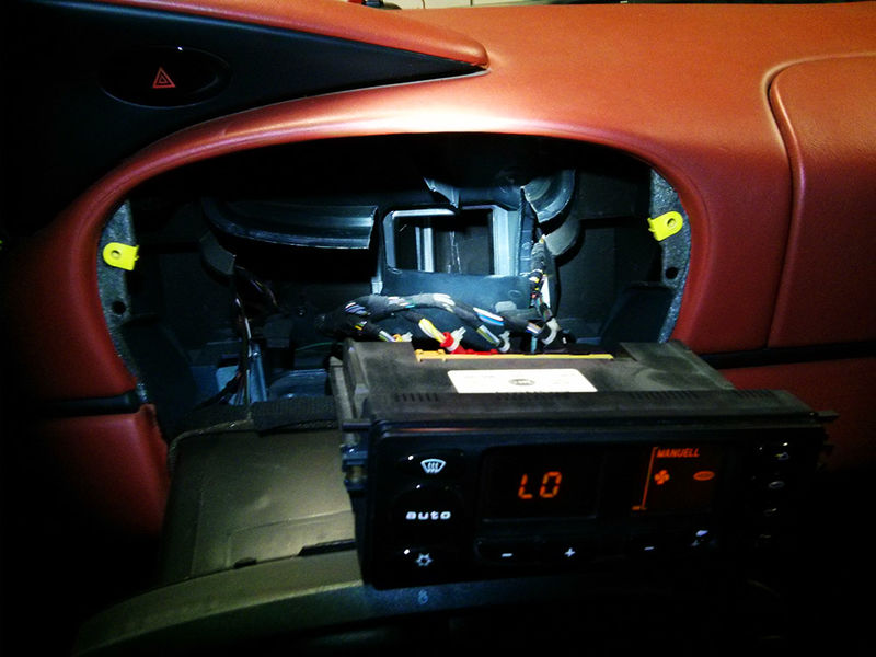

Accessing heater flap through dash
There's a tutorial on how to fix the AC/heater flap (from loss of foam) by going in through the dash. I've seen it before but I can't find it! Anybody know the source for it?

Yes! That's it, thank you!
Old 11-09-2018, 05:03 PM   #4
No problem
The fix works great! It nice to not have bits of foam hit me in the face anymore.

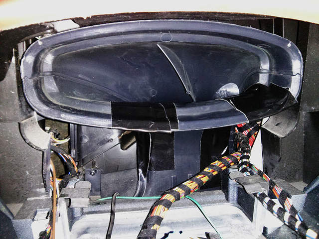

Did the fix last fall, my doors were naked with virtually no foam left... that made the fix easy. I used waterproof alum tape from Home Depot to cover Swiss cheese holes on doors and opening cut on the hvac housing, easy to position and great adhesion. Very satisfying results to restore quick and powerful heating, warm air just a few minutes after cold start, what I exactly need for my daily driving through Michigan winter.

ABSOLUTELY this is the method to do it! Wow it was so easy. I am so surprised every post says to go in through the frunk. Forget it!
