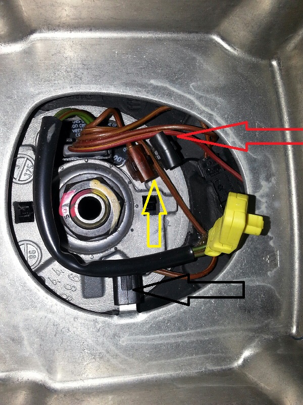

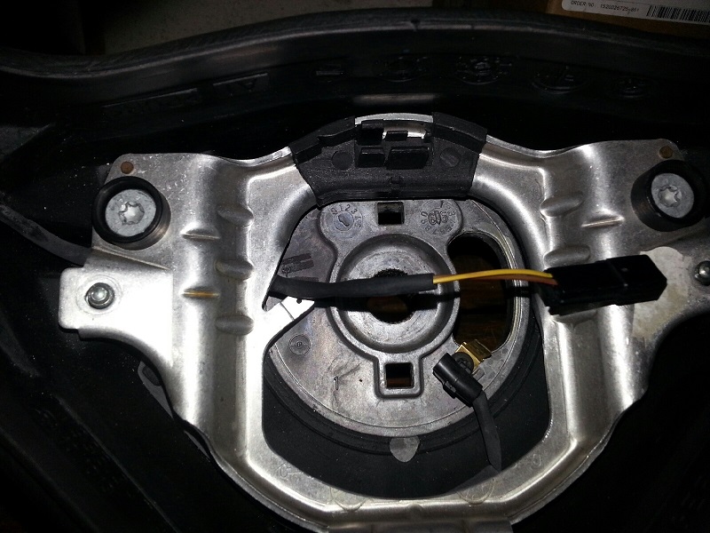

Starter986 11-10-2018 09:18 AM
2 Attachment(s)
98 986 Tiptronic...
So... air bag off, and this is the wheel I'm installing...
Attachment 21741
Here is what I'm looking at, and it's confusing me...
Attachment 21740
So... where do the connections go? I'm lost. Thank you.
Geof3 11-10-2018 09:31 AM
The wires you are looking at are coming off the clock spring. The tabs are all ground. It would appear the new wheel might have a different connection for ground than the old wheel as there is a similar black connector on the base tab. The base tab would be "chassis ground", the airbag carrier completes the ground loop when the horn is pressed.
The brown ones are just ground for the horn, short one goes to the base tab, long one goes to the airbag/horn plate tab. You'll have to look at the wiring in the new wheel, they may not be compatible? Or, you might need a newer clock spring? Mine isn't a Tip so I just had the horn grounds and airbag connections.
Starter986 11-10-2018 11:28 AM
The existing wheel bolt was very easy to remove. Almost 2 easy. It felt hand tight, and then maybe a little snug with a socket. Hmmmm.
When I began taking off the wheel I did see the clock spring wiggle a bit and, knowing from what I read... and a couple pictures I had seen... blue taped it so it wouldn't budge.
Once I decided that the number of wires paled in comparison to that of a super-computer... I slowed down... used a couple markers to mark the new wheel connections and to where the wires from the clock springs met them. It started making sense. It wasn't so complicated (I over analyzed).
Unfastening the Tip connection from the existing wheel took some time until I figured out how to disconnect the connector. I didn't want to break anything.
Pulled the clock spring wires through the hole... positioned some here... some there... so that nothing risked chafing... plugged everything in.
After I lined up the new wheel I remembered to remove the blue tape. The steering wheel was well seated, almost all the way in... and slowly I peeled off the tape then completely seating the wheel.
Reattaching the torx screws, yes, was the most challenging. Patience was key. That took me 10 minutes until I was satisfied.
OK.
Positive connected. Negative connected. Turned key... started the car... fired up... and lights started going out. The only light remaining was the spoiler light... and I know that goes out after a few seconds of driving.
So... Success. Thank you to those who offered up advice.
