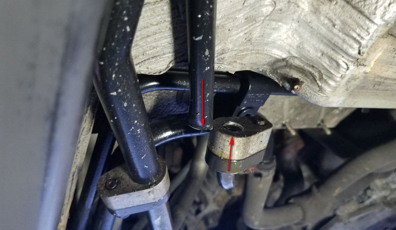

After 30 minutes I think I was able to attach a pic.
I originally posted this because I thought it would be fun to hypothesize on what it could be before I looked.
After looking, I still have no idea.
The arrows point to where these lines should be connected. They are a pair black metal lines that run along the length of the passenger side. The pic is me under the side looking towards the rear of the vehicle.
The fluid was a real green, almost neon, color and it did smell like gear oil.
Picture is worth hours of speculation. Looks like TRK nailed it. Those are the AC lines and YOU were right on the gear oil, supercooled AC compressor gear oil.
